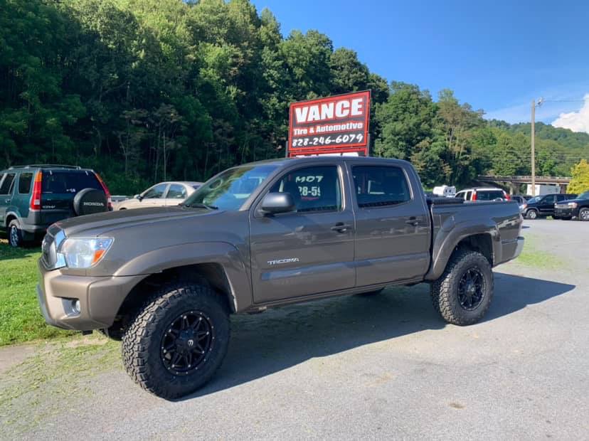

    A8FAA882-38D3-47BA-8598-E503855B2A89.jpeg I had a toytec lift put on my 2012 Tacoma and everything is good except that it’s making a noise that sounds like it’s coming from the drivers side front. It quits if I go around a right hand curve. Doesn’t quit on left hand turns. Any ideas? Thanks
