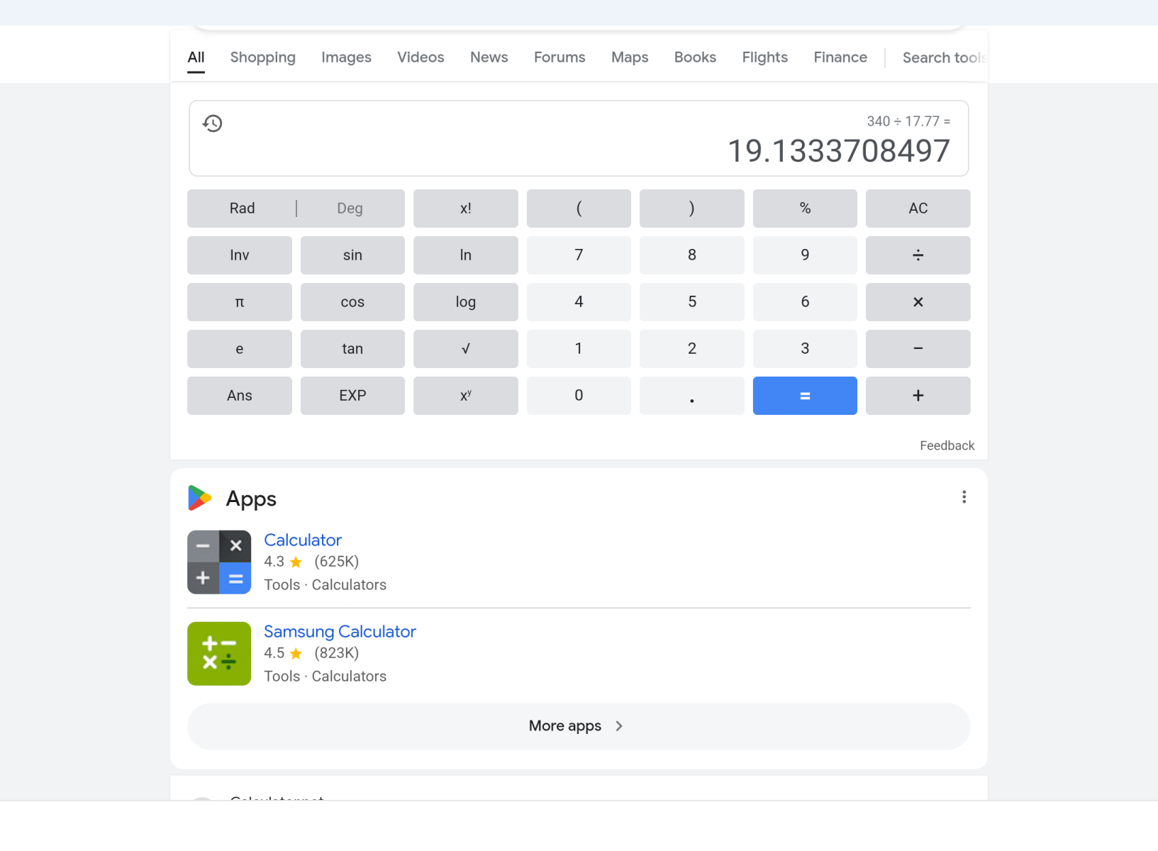

Last tank full seemed a bit better on shell e10 87 octane
340 miles wheeled on nearly 18g
Is it slowly self-healing??
Still a 30 mile per tank dropped from the norm before 341k
