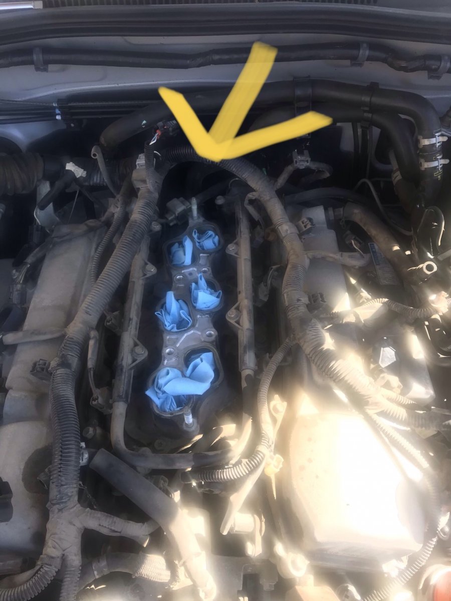

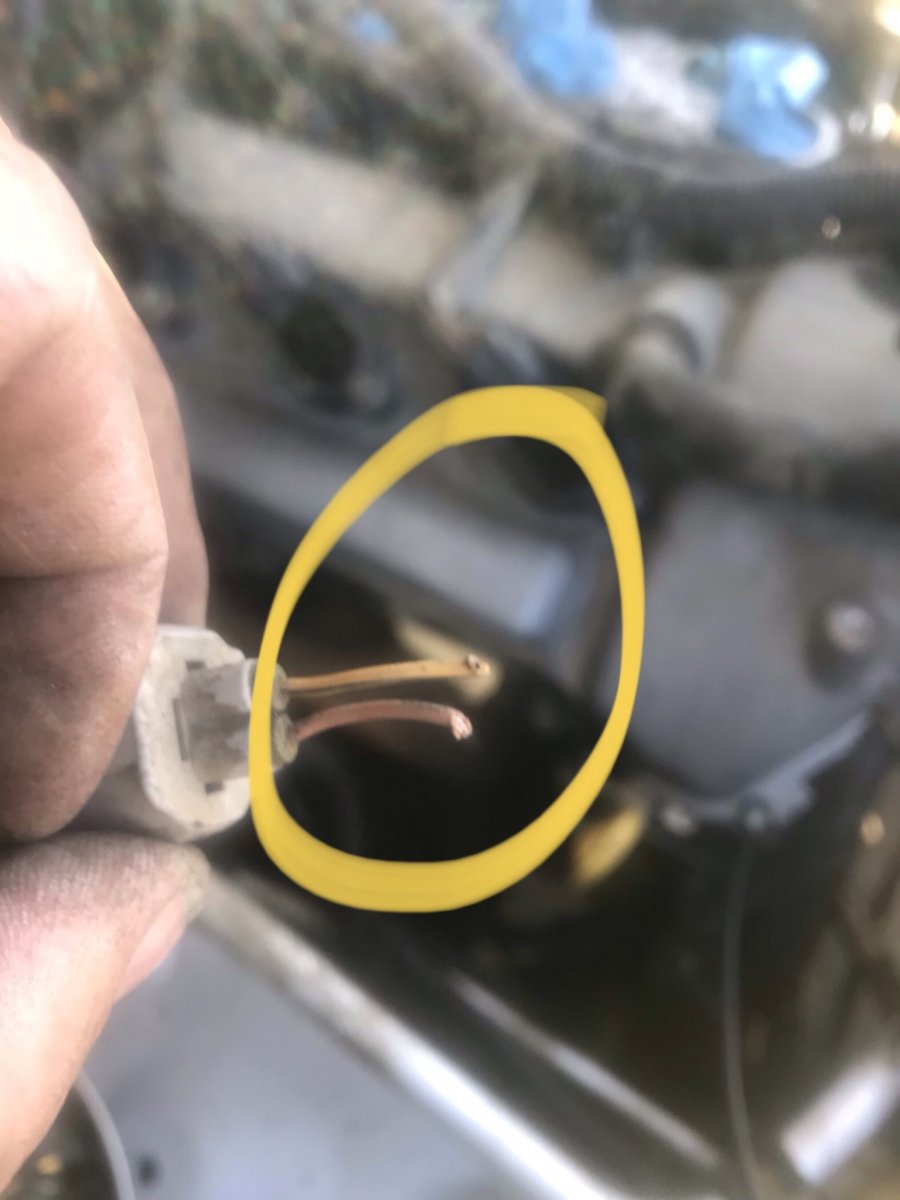

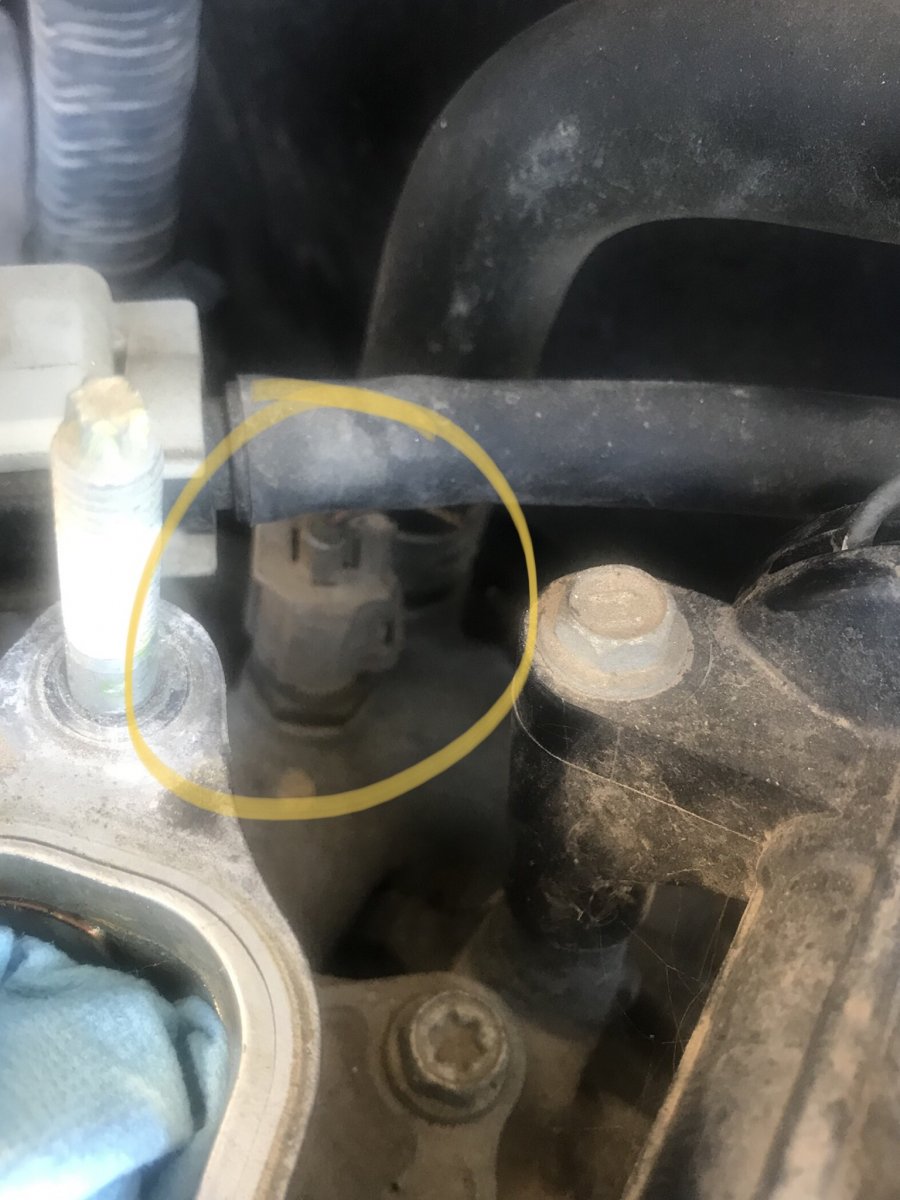

    A78659EE-1C4B-4977-8A6D-359588FFBC8D.jpeg 8511FB00-6BC0-44ED-9D40-1B5BA2DCA925.jpeg B7A0DB4B-4EC0-4E8B-BCBF-43E44B2DFADA.jpeg The problem was found to be both wires for the sensor had been cut and badly spliced sometime ago.
    To get to the sensor, you have to take the entire upper intake off, remove the pass side fuel rail input line, remove the coolant hoses that go to the throttle body, and lots of pesky wiring clamps (one hidden behind the intake below the coolant lines), and a DEEP 19mm socket, and drain a bit of coolant.I swapped out a new one since I was that deep into it, and she fired right up once bolted together. Good luck, take your time.
