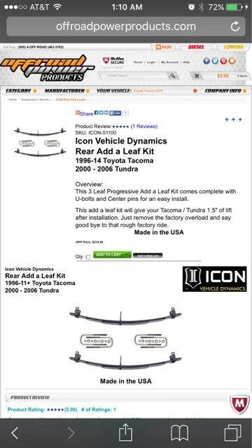

Are you talking about this?
Put this in place of the overload spring? Tell me about this.
