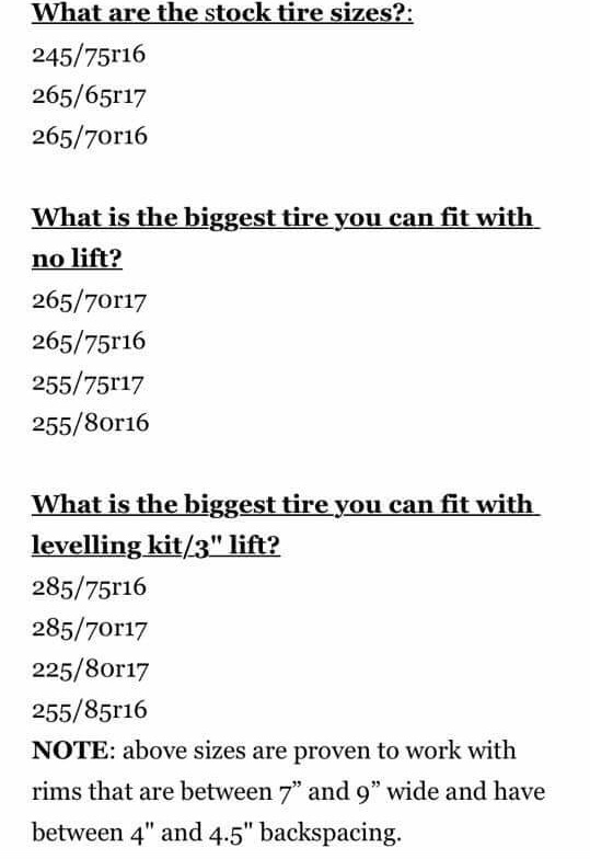

  6. OR17TRD
    What do you have? 2005 Tacoma 4wd? Prerunner? 2wd? lift? Stock tire are 245 or 265? rim size, 16x7? 17x7.5?
    4wd or prerunner Tacoma 265/75/16 or 265/70/17 on stock is the largest you can go.
    Ricks2012, B-Man and wbfischer like this.
  7. OP
    wbfischer
    wbfischer Active Member
    The 265/75r16 are what I was thinking of going with. Currently have the 265/70r16
    I figured an inch in diameter difference shouldn't be problematic
    B-Man likes this.

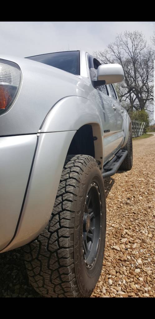

  10. kp.taco
    kp.taco Well-Known Member
    I have the dynapro atm's. 265/70/17 they're good tires, no complaints here. I'd buy them again
    OR17TRD, B-Man and Ricks2012 like this.
  11. kp.taco
