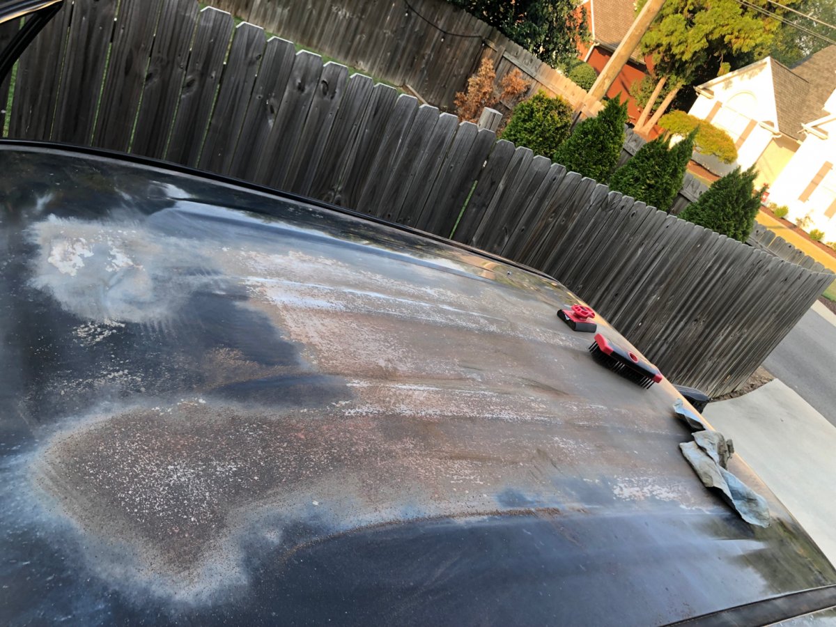

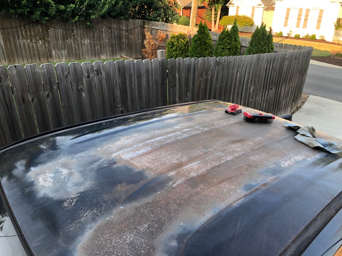

Toyota Tacoma rust on the roof.
You should get a drill and put a wire brush bit on it .I use this stuff called rust off its a spray and it has a reaction with the rust and turns it black it smells like metal conditioner we used to use in the body shop on bare metal .Wipe it good . I would paint POR-15 on it. Which stands for paint over rust its good stuff . Maybe spray it with truck bed liner .it will look like a vinyl top. If u are going to paint it with rustoleum make sure u use a metal etching primer .it seals really good .hope this helps good luck!
