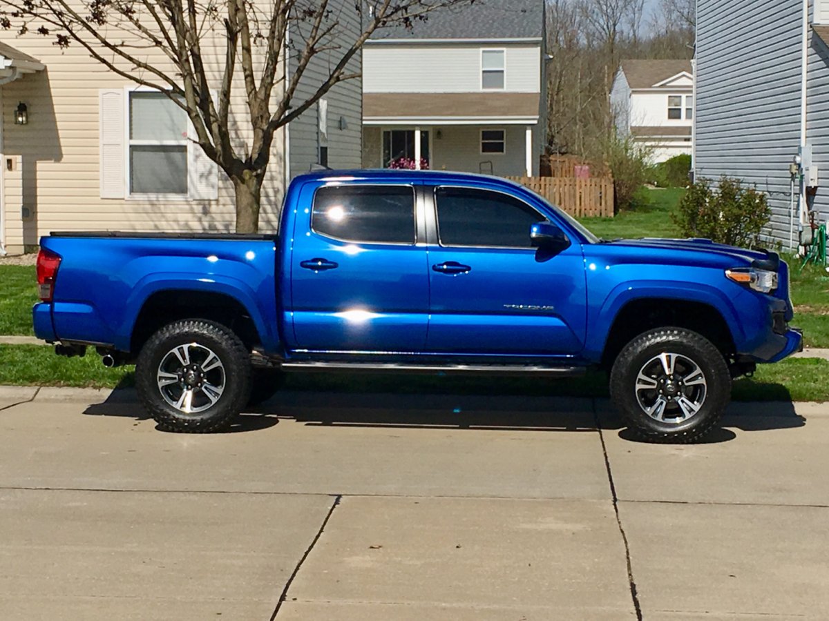

  11. B-RI
    B-RI Well-Known Member
    These are with my 2 inch
    Isaac s and B-Man like this.

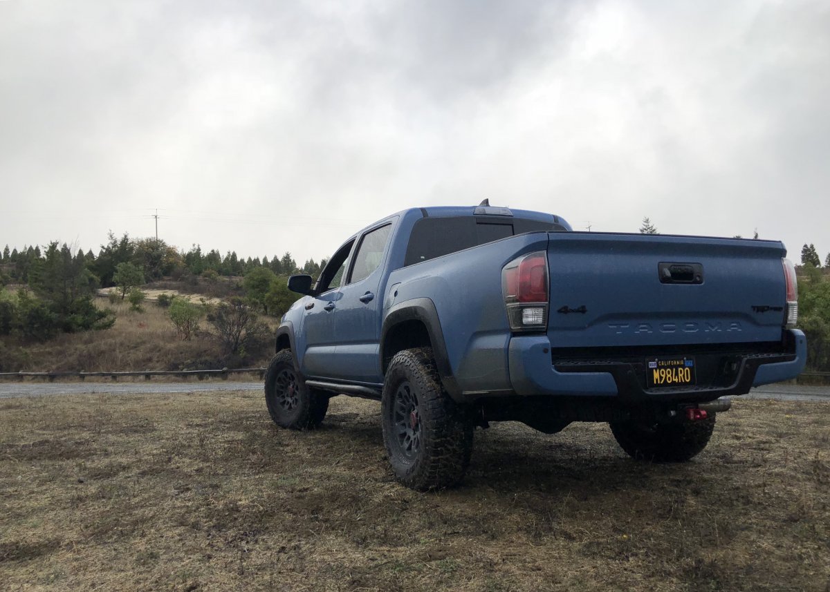

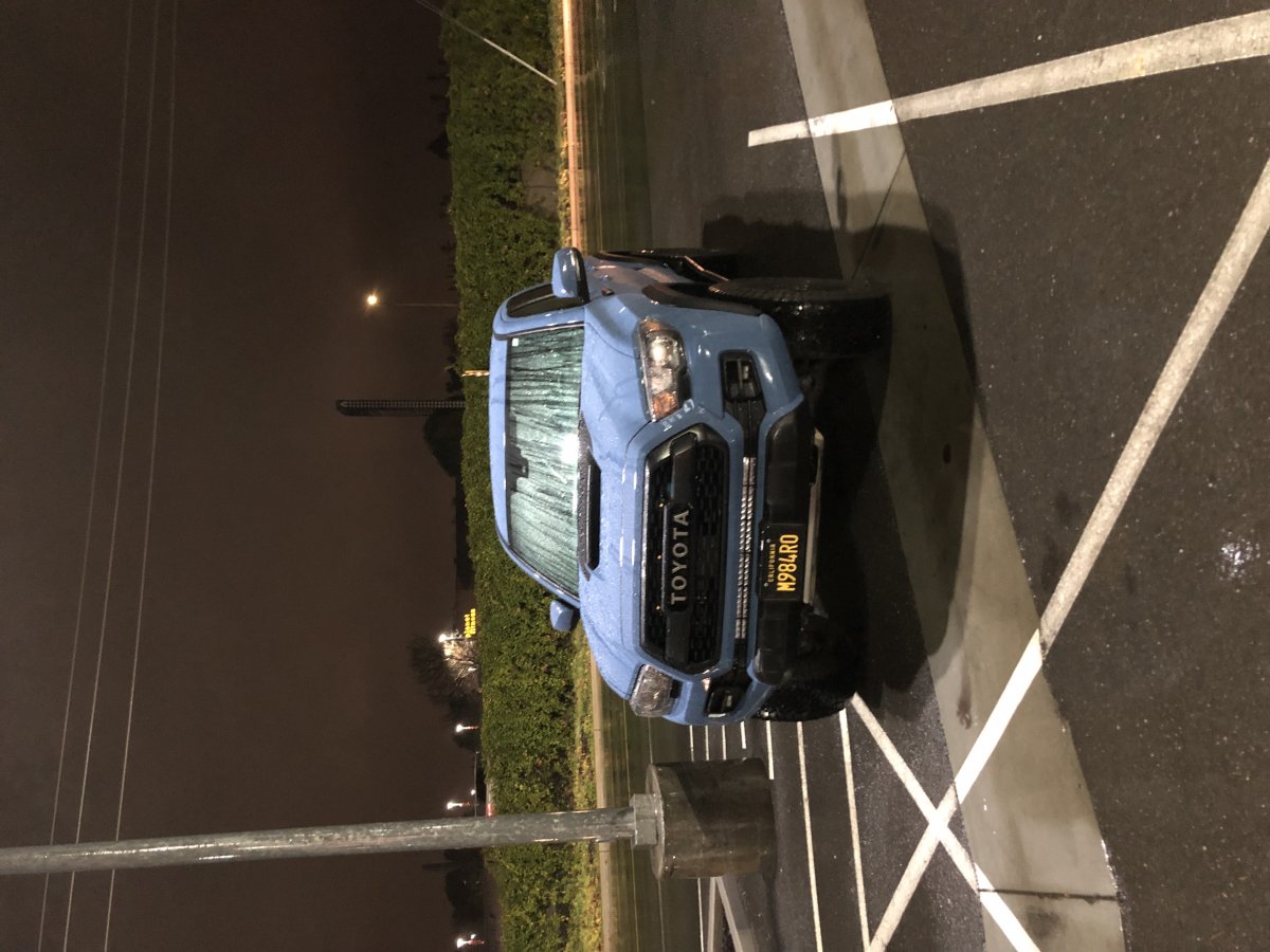

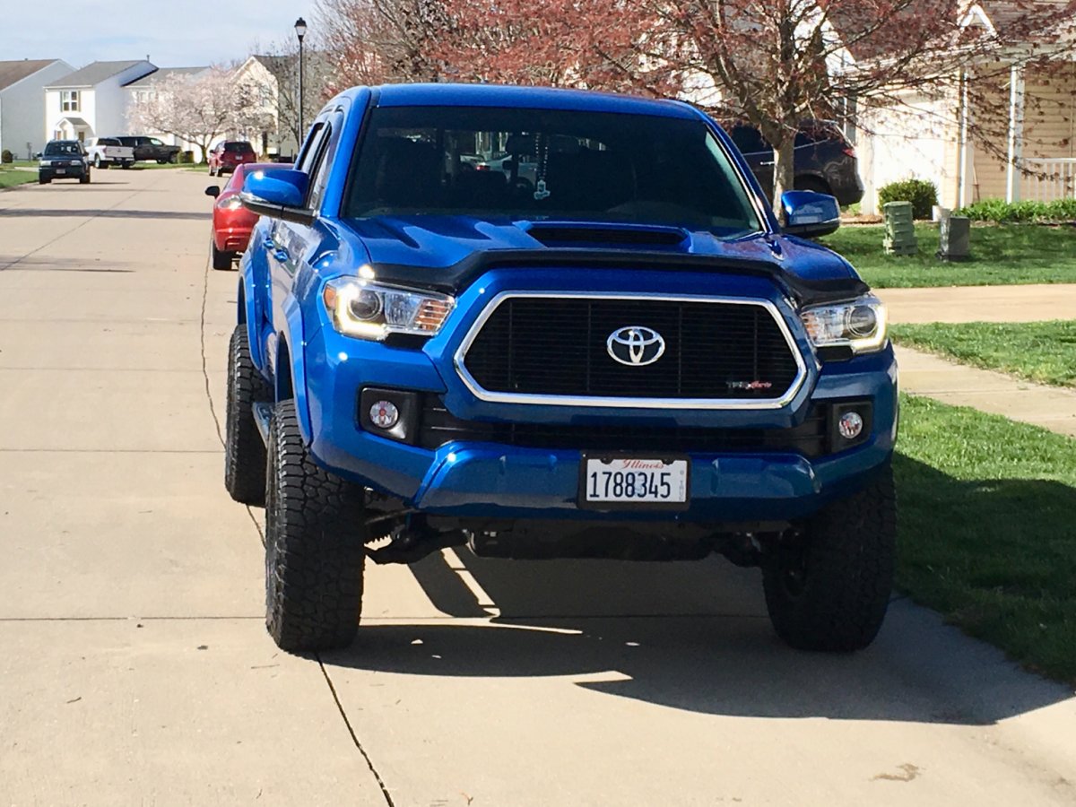

  17. Toki
    Toki Well-Known Member
    E1947E72-08AC-4BA5-B149-0BF3533ED4D9.jpeg 156EF9E1-A4D8-4EE5-A076-83CD4B6E5952.jpeg
    I needed the spacers to clear my uca’s. I just got new -38 rims which then I will take them off.
    OR17TRD and B-Man like this.
