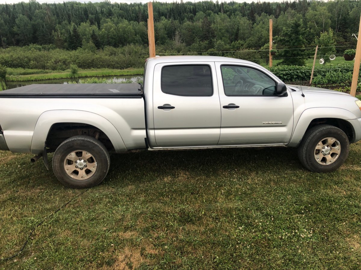

I just bought a 2010 Tacoma SR5 with 400,000 Kilometres on it and it runs great . When should the timing belt be changed and what does it usually cost at the dealer IMG_1162.jpg

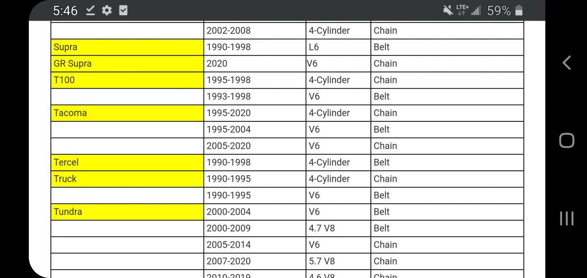

Thanks BC, is there I point when it needs to be changed do you know
Like TacoKen said, when you have to rebuild the engine, replace something like a blown head gasket or leaking front seal, so you're already in there, then throw in a new chain and gears. Never replace just the chain, buy all 3 as a set, and replace them.
