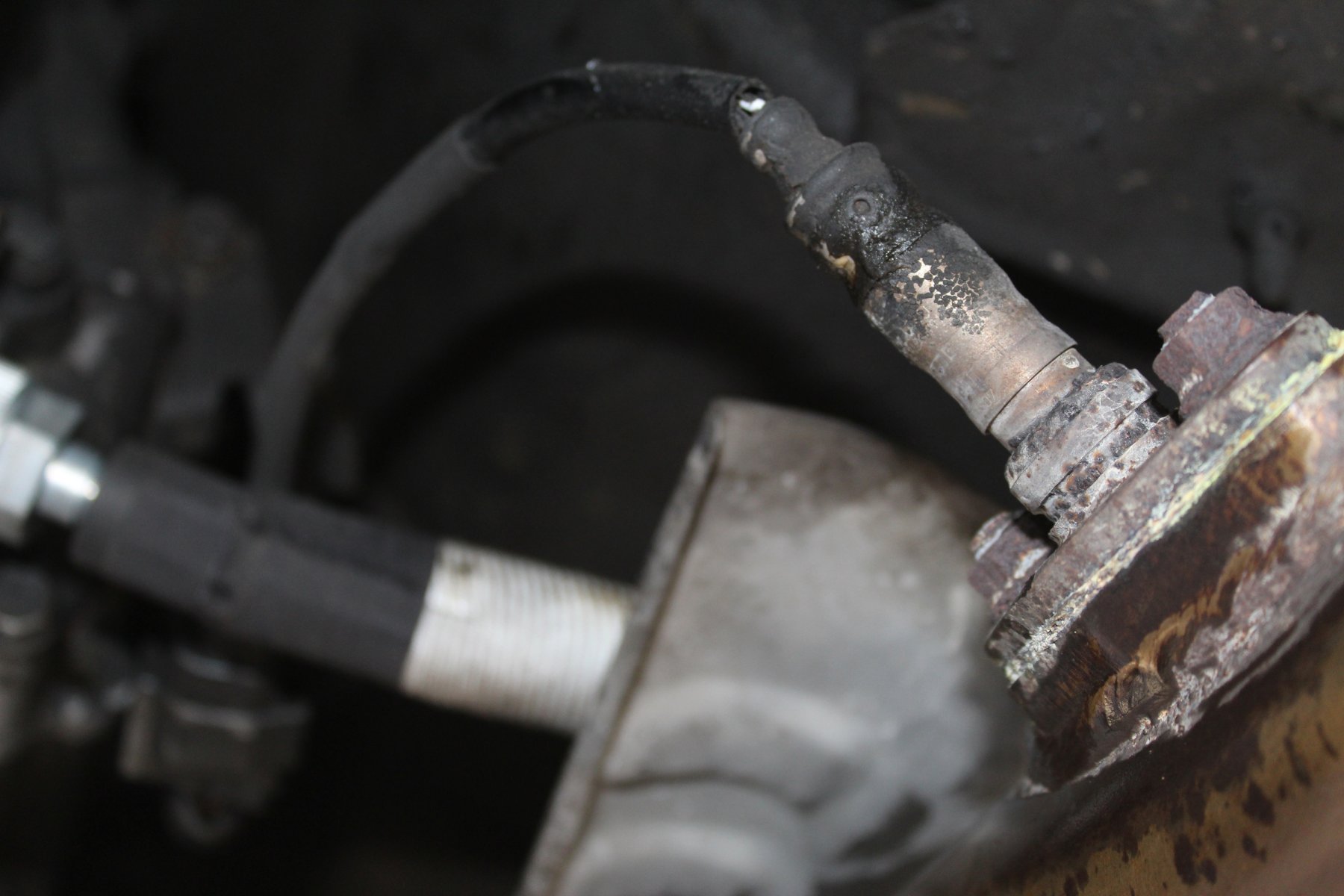

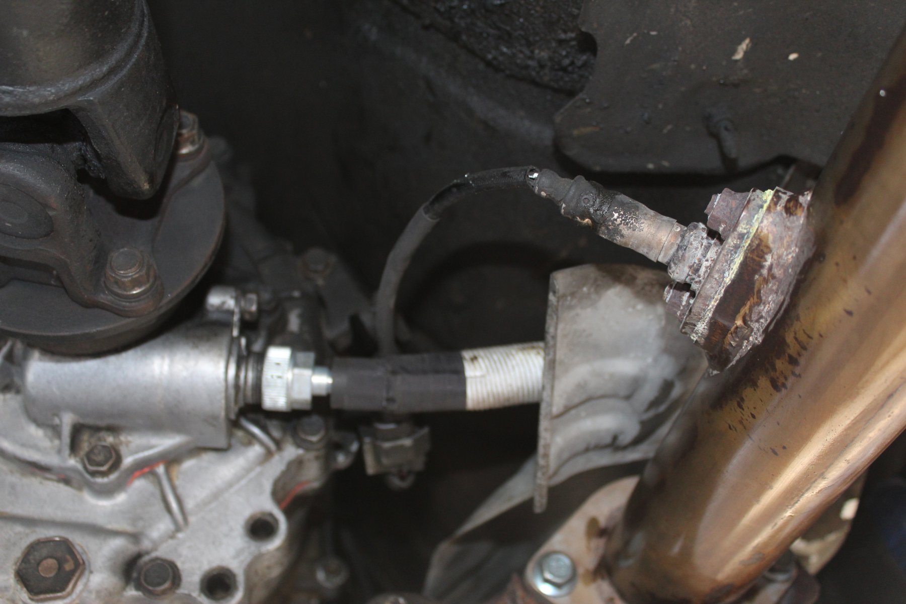

the front exhaust (including the cat) was disconnected and opened for an extended period of time, who knows how long
then that downstream 02 sensor wiring and harness that was just off and dangling all wobbly in the find
pic was posted on the EDT topic
do i need to submit another image of whut was found into this thread?
i have yet to take a gander at the upstream 02 sensor :confused:
NO CEL has triggered as of yet

can the 02 sensors be tested before porking out +200$ for new oem
they may be easily removable but IDK lol
its been 5 years since removed from pipe with new nuts and they lookin' crusty a bit
