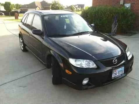

I bought this ImageUploadedByTaco Forum1378443244.069936.webp from a friend for $120 and I am selling it this weekend for $2500 and with that money, I am going to add some more stuff to my truck. The first thing I wanted to do was buy a lift and I was wondering what brand should I stay away from and whatnot.
