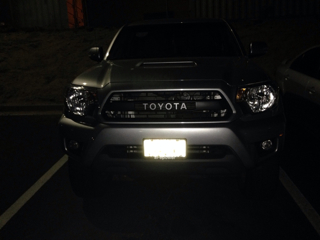

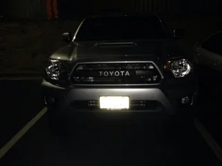

Hello . I have lift my taco 3 inches and lately it's been shaking little . @ steering wheel kind of often ! Any advise thanks
phillipvnvn..
That could be your steering intermediate shaft (connects your rack to the steering wheel)?
