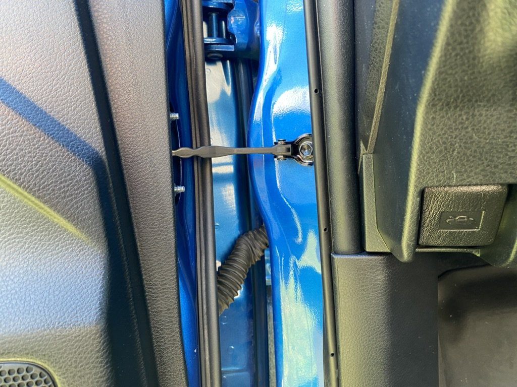

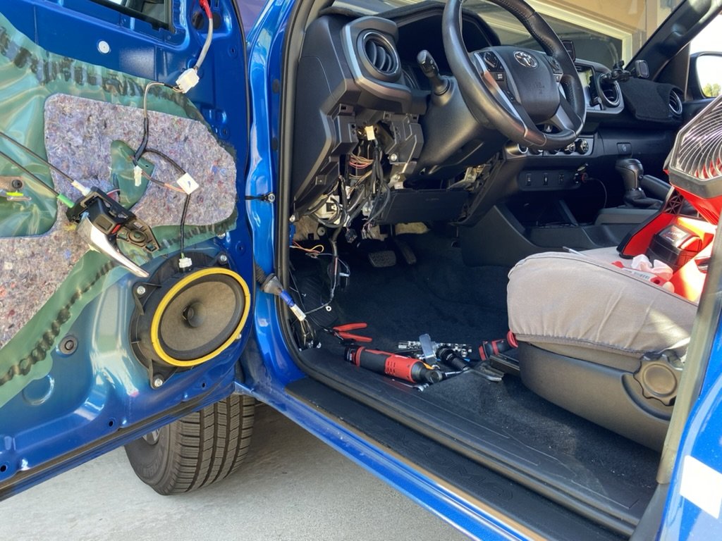

My Tacoma developed the dreaded "Clunk" while closing the driver door (with the window down). I ordered the door check assembly (P/N 68610-04030) and while installing it I discovered that the bolt on the door frame side of the door catch was just spinning as I tried to remove it. (due to the nut on the inside had broken free from the door frame). WELL ****!!!! It was 100 degrees outside today and I didn't feel like sweating my ass off so I called the "Stealership" for a quote. Without the bolt extraction the quote was $465.00, JUST LABOR! For them to get the bolt out and install the new door check it was $750.00 labor plus a diagnostic fee to verify that the nut was indeed broken free from the door frame. They said "plan around $1000.00 out the door". Sorry Toyota I just couldn't hand over a grand for a stuck bolt. Three hours, lots of cussing, and a gallon of sweat but it's done and my Tacoma Clunk is gone.
