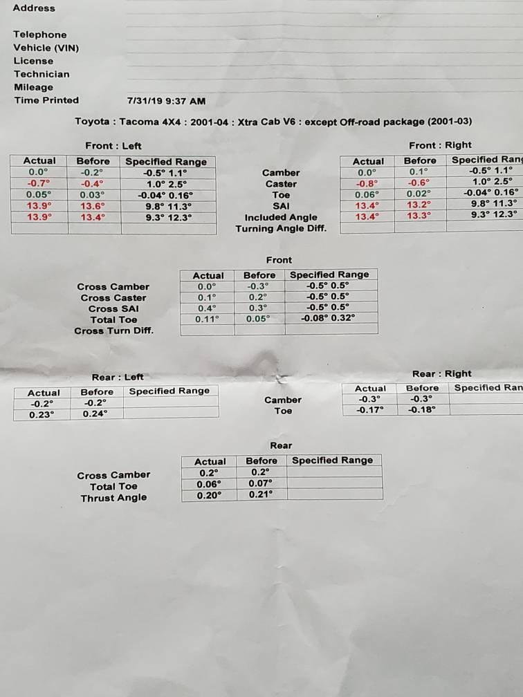

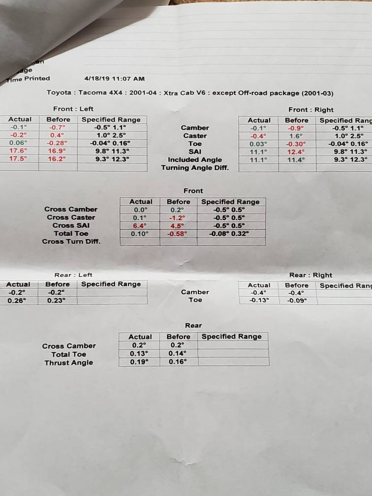

Any idea what these numbers mean? Might as well be another language for me20190820_211752.jpeg20190820_211744.jpeg
Any idea what these numbers mean? Might as well be another language for meView attachment 26996View attachment 26997
I've never seen anything like this. As it says, it all has to do with caster/camber and toe in. I had mine aligned once after about 200k miles. Didn't make any deference of course.
