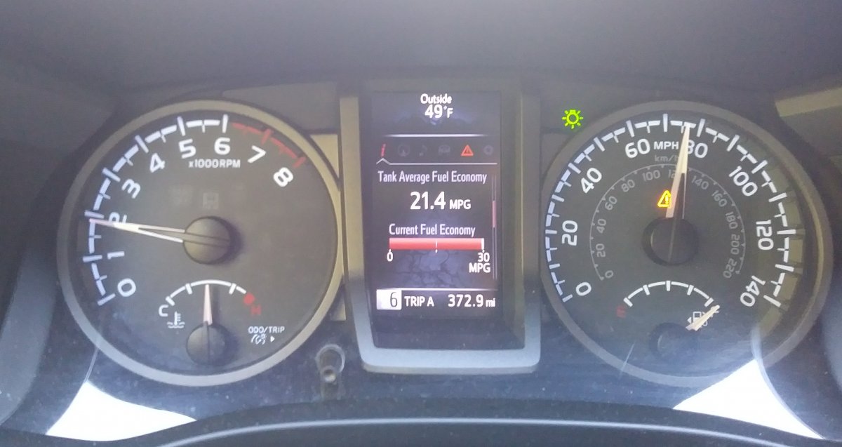

View attachment 21104 Hey guys just came back from 800 mile weekend trip to lake George new York and on the highway around 70 - 80 got a whistle .I think from mirror , like blowing over the top of a beer bottle ? WTF ! Only on drivers side any cures for this it was driving me &;:,:/=,(££× . nuts ! Got great gas mileage though in 5th gear didn't use 6th to much gear hunting on hills !
