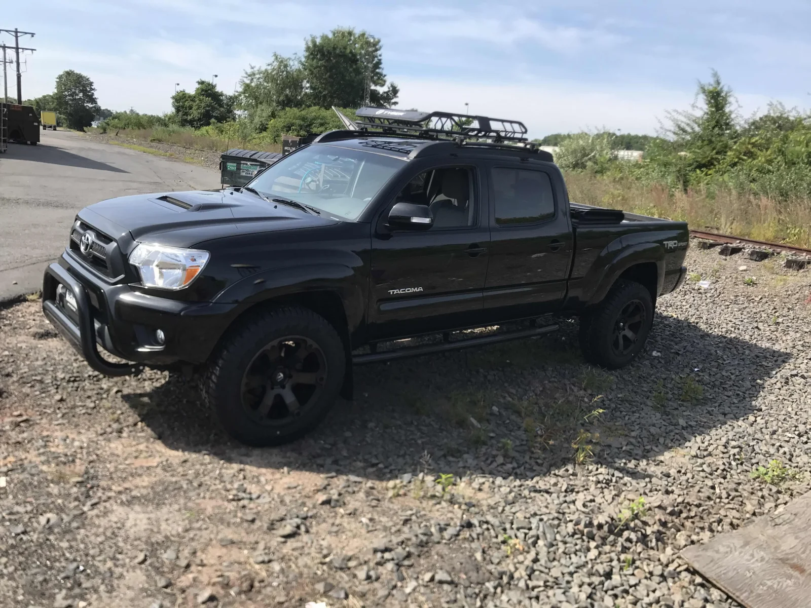

    New 2inch lift with 20 inch black wheels
  12. billyboston707
    billyboston707 Well-Known Member
    Love everything besides the 20s. Not a fan of anything bigger than 18s on trucks
