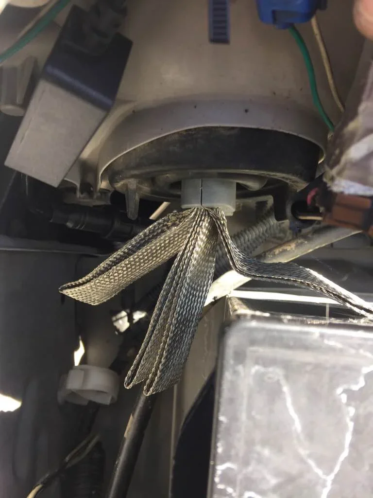

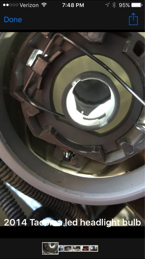

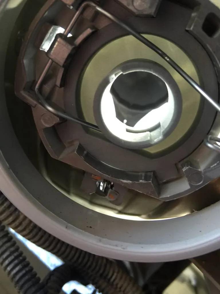

I just recently changed out my headlight bulb with a led conversion kit and it's awesome! But I left out that black rubber piece because I thought the LED bulb would get hot and melt it... But now I have moisture inside my headlight! Should I put that black runner piece back on?

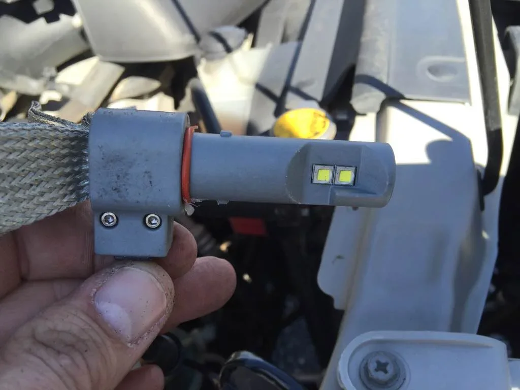

Take a pic with the bulb in right now. The Putco 's I put in my 07 a few weeks ago had a removable 3 tab flange that holds the bulb into the len . It twisted off, I put it into the len snapped the wire pressure arm in, then Toyota rubber grommet , install the LED in the middle push twist sealed.

This piece twists off the LED bulb and installed , then rubber grommet is pushed on and a whole remains for the bulb to go into then twist done.

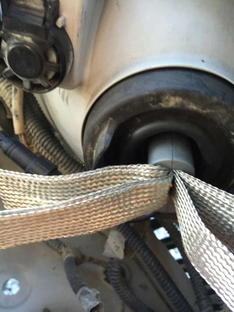

Hey can you take a pic of how your light looks with the rubber piece on it?? You installed a led bulb correct?? I put that runner piece on and I still get moisture in the headlight
My 07 Putco led have that twist off flange . So they are installed with the factory rubber grommet. If those don't twist off like mine. Your going to have to put a small cut from the center out . Just a small one enough to try and get it over the fan.
