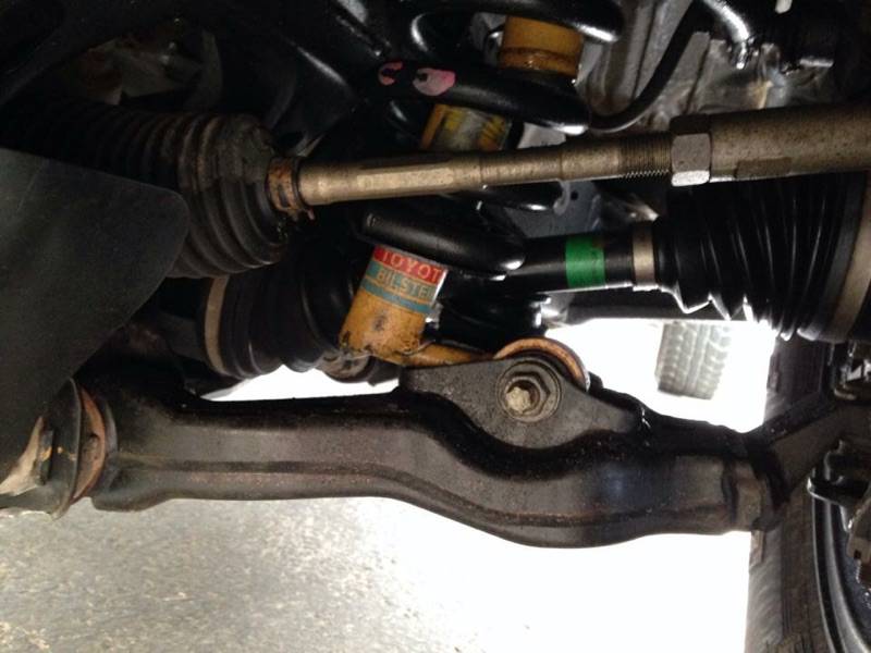

  17. OR17TRD
    The stock bilstein 4600’s aren’t anything to get to excited about. 5100’s are much better and adjustable.
    +1
