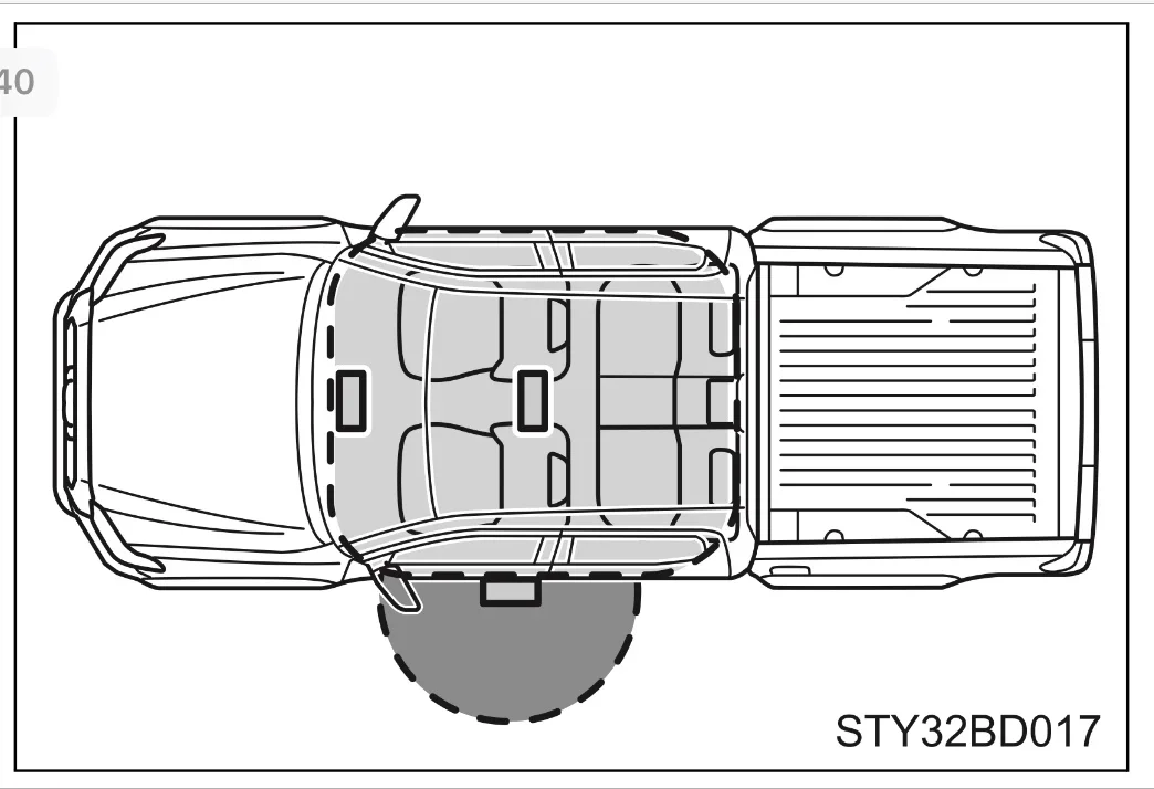

There is a significant difference in the distance the unlock/lock/panic buttons will work on your key fob remote as opposed to the keyless entry by touching the handle and the push button start due to safety reasons.
When you go to unlock it by touching the handle you have to be within close range (usually within a couple of feet of the door like the key in your pocket).
When you go to start your truck the key fob has to be within very close range (within the cab of the truck).
These are safety features to keep your truck from being stolen as OR17TRD pointed out in the previous post.
