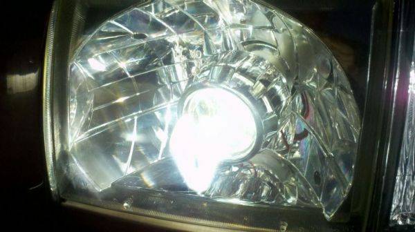

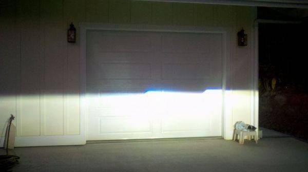

Just replaced my stock headlamp bulbs with Sylvania Silverstar Ultras..
Got some extra light without going HID:thumbup: Pretty happy that I did not have to modify my truck... just plug and go!!
