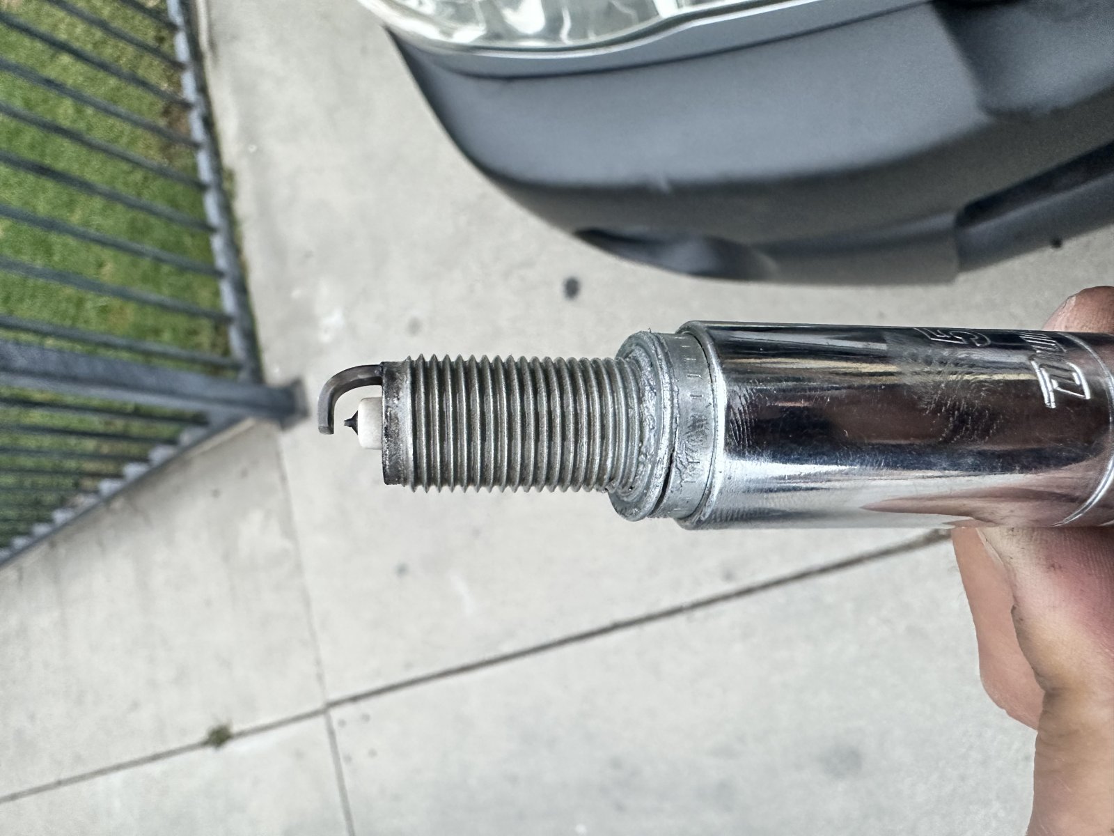

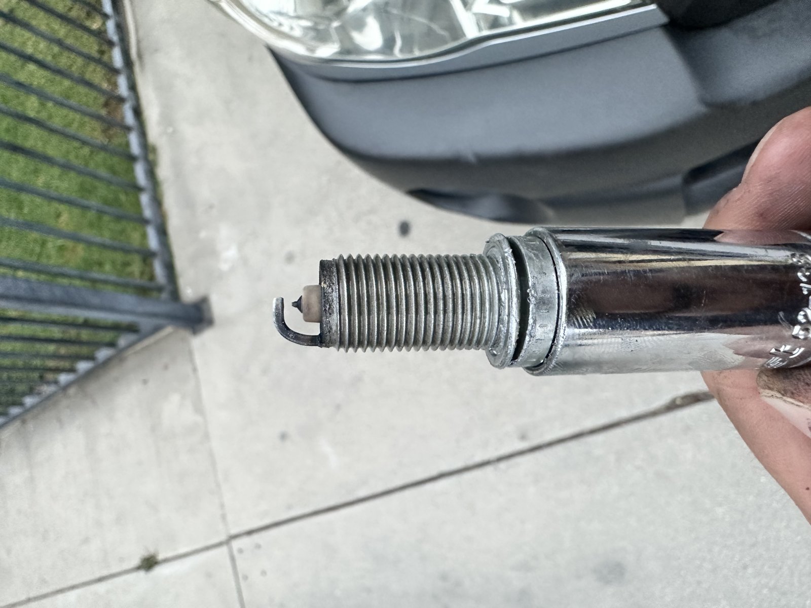

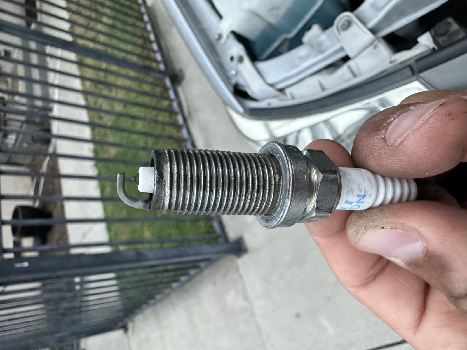

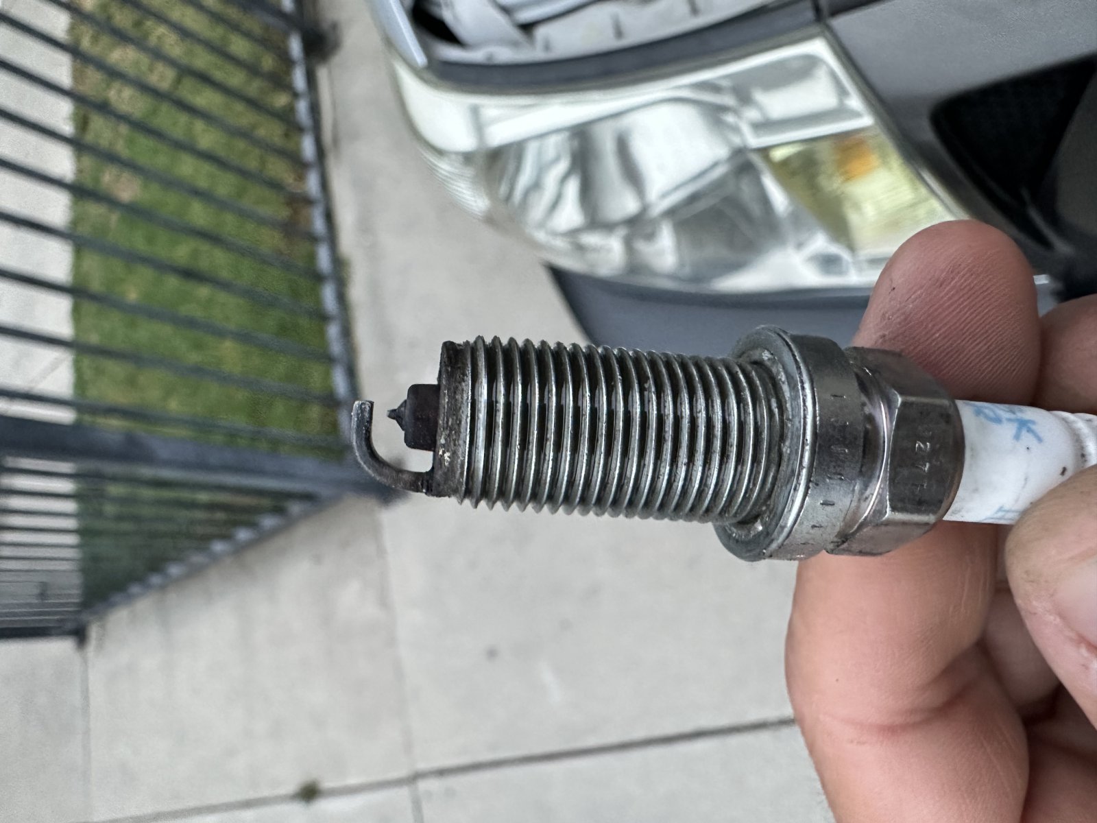

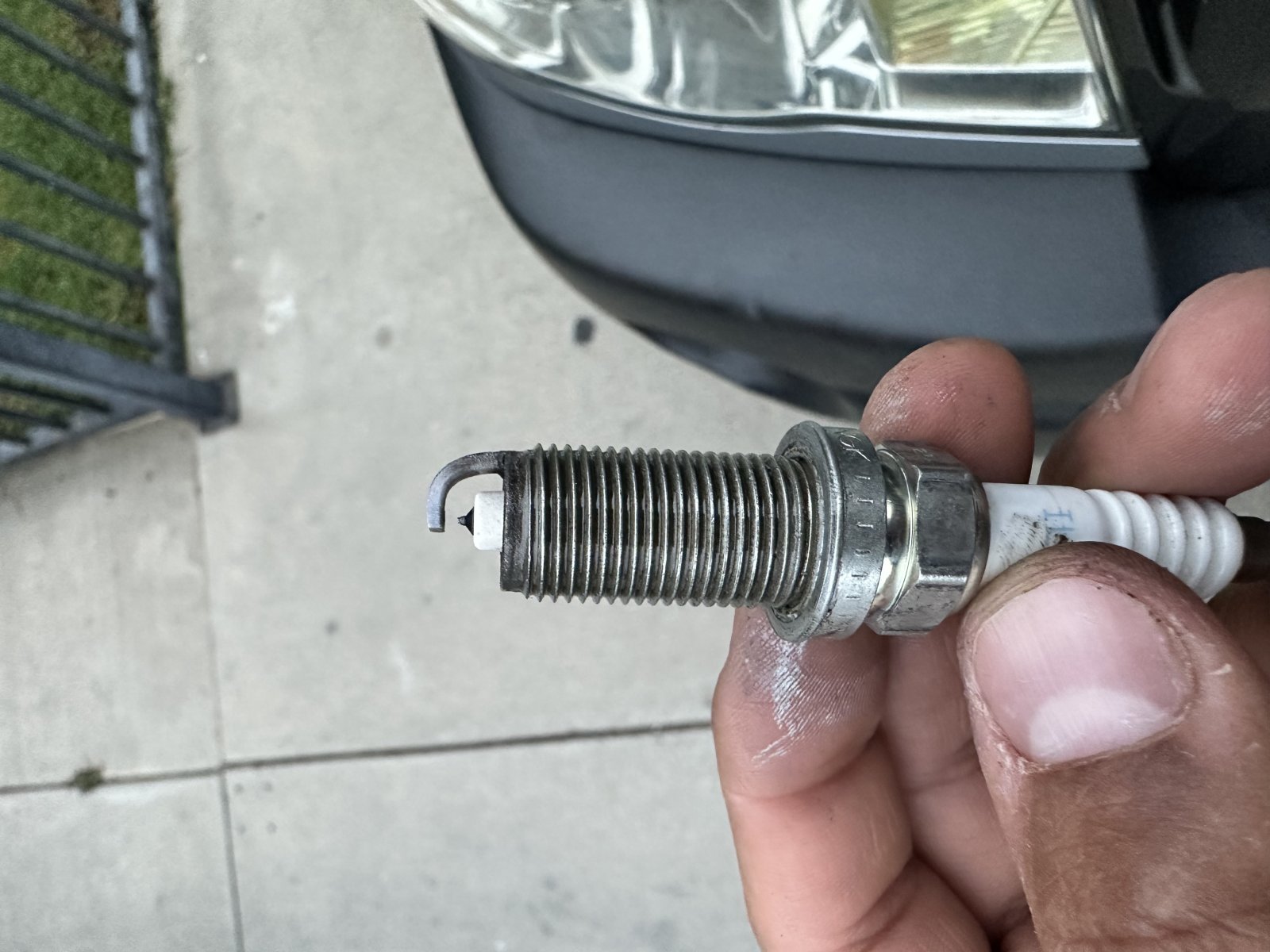

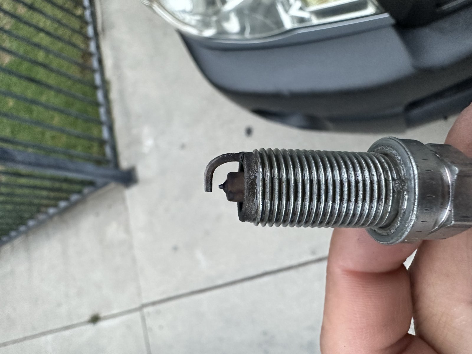

So as I have mentioned, I put new spark plugs last week. As you can see on the first two pictures, that’s spark plug on cylinder 2, where the misfire is occurring. The white top part is very dark. There was No oil though. Spark plugs for cylinder 1 and 3 are pictures 3 and 4 and they look fine to me. Spark plug for cylinder 4 does show a little red dark one on side, perhaps a fuel injector issue. But there’s something going on with cylinder 2. What would it mean if the top white part on cylinder 2 spark plug is dark like that?

I agree it is probably oil getting into Cylinder #2. Now, the question is.....From where is the oil entering?
Head gasket keeps anti-freeze out of the combustion chamber. I don't think head gasket is likely.
At 180,000+ miles, the oil control ring on Piston #2 is a likely suspect. Another suspect is a scored/cracked cylinder, but that is ruled out due the positive results from the compression test.
Unfortunately, getting access Piston #2 is a MAJOR task. But probably much less cost than a short block.
If this were my situation. I'd run the electrical diagnostic first, then fuel injector. Rip into the engine as a last resort.
Good Luck.

Being dark means that cylinder is run cold I always replace wires then I know for sure that that link in the chain is good. If you check all the cylinders and they are all with in the same psi + or - 5 the cylinders are good but you should do a wet test also a little oil in the cylinder it should not change if it does bad rings.

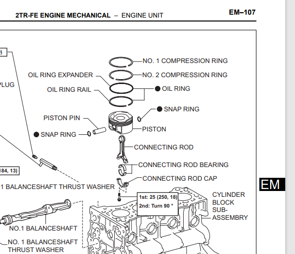

The oil control ring on the piston can not be tested with a compression test. The rings above (near the top of the piston) will form the seal.
An oil ring is basically a scraper designed to remove oil from the cylinder wall. When the oil ring quits scraping, then extra oil will be in the combustion chamber to be burned. Inside the oil ring groove there are drain back holes for the oil to return to the sump. If these become plugged then the oil can't drain back and will find its way into the combustion chamber. The common method for the drain back or oil ring fouling is extended oil changes or poor quality oil.
The oil ain't coming from the head gasket.
Suggest getting a bore scope. Remove the #2 plug. Rotate the engine until #2 is bottom dead center. Use the bore scope to inspect the cylinder walls for any signs of scoring.
I've seen many engines when torn down with over 150k miles have broken oil control rings. Usually it's not just one cylinder which is strange, it's nearly all of them. I'm still leaning toward a bad head gasket as the main culprit. As far as the rest of the block, its likely a crap shoot that it does need replacement for long term reliability.
