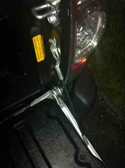

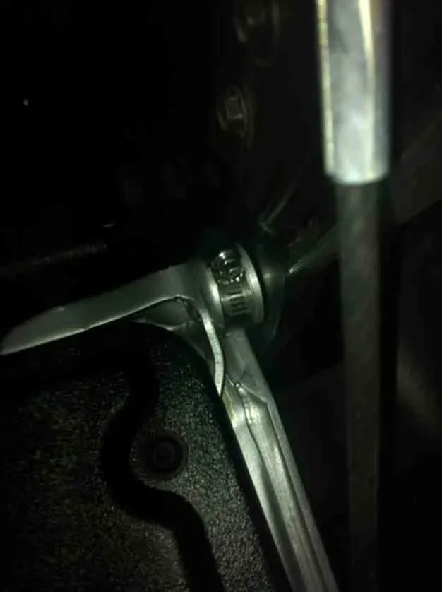

Took less then a minute. Just curious if anyone else did one clamp or did two and clamped each side. I'm adding the second one today just to make it more inconvenient if the thief happened to be caring a flathead on them. ImageUploadedByTaco Forum1375992728.938068.jpgImageUploadedByTaco Forum1375992741.168185.jpg
Driver's side won't prevent theft since it is a full cup on that end. The passenger side is where the tailgate releases.
Driver side has full cup, passenger side has the cut out for removal so to prevent theft you install a key hose clamp 3/4~1 3/4 in to prevent theft but you also need to do the washer mod on the check strap since you can still wiggle the tailgate off with the clamp in place.

Yup. I'm derping. I mixed the sides up. Passenger side is the release side. :facepalm:
Fixed my posts.

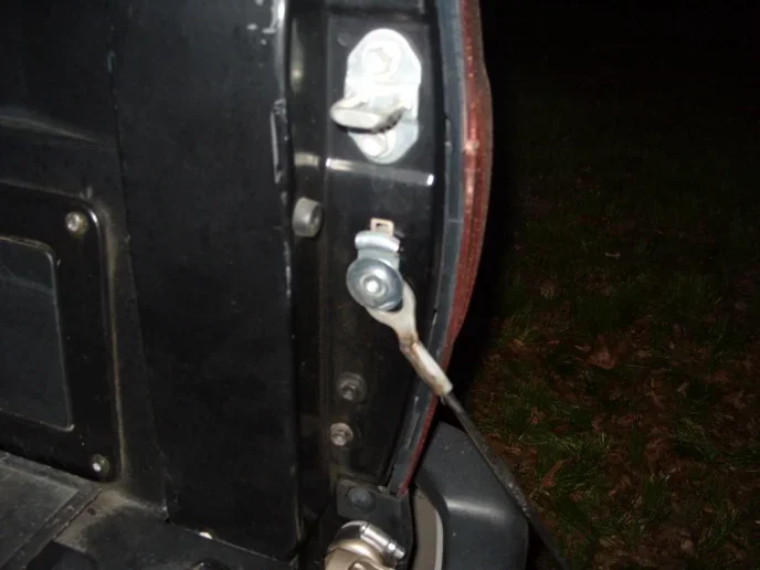

Stainless Steel washer from ACE Hardware. I took the hex screw in with me to get the size that fit it. Cost about 15 cents. And then used locktite on the screw since you can't tighten it down all the way or the cable will bind.

OreCoastie doesn't have the washer on his cable where it attaches to the bed in his photo. You can see it in my photo.
Also I used this clamp since you need the key to turn it. Cost about 2 bucks at Advanced Auto.
