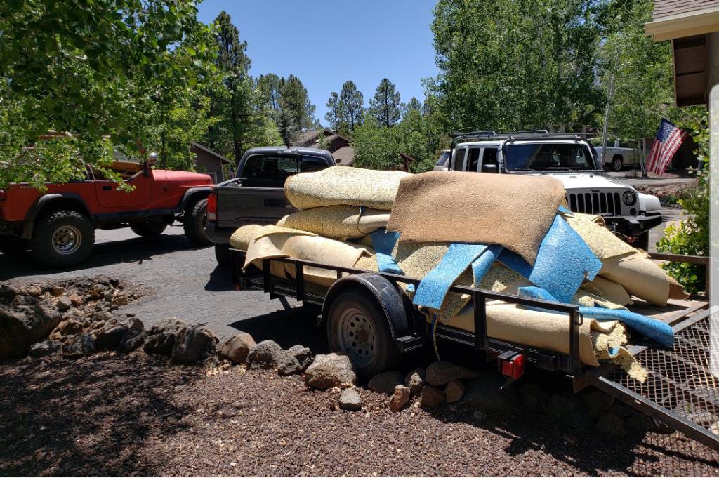

Calling all hands... calling all hands.
Exactly! Haha! I just finished putting a hot tub, with underground electrical, pavers, a gazebo, went all out for the white jeep. And I keep the red pos jeep running and built a rear bumper with a tire carrier and can holders a while back for it. Time to call in all favors. Haha!
Those floors will be so much better than that nasty carpet haha
For sure. I can't wait to see it done. Haha! This looks like its going to be the easiest flooring I've ever done. Just a lot of work to get to that point.

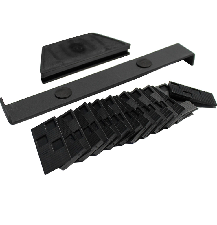

Get an install kit with the spacers for the walls, the setting tool and a rubber mallet. I use a piece of the cut flooring to attach in the groove so you don’t mess them up when knocking it tight. Run it length wise the same as the longest length of the house. Cut the floor to fit the house don’t try to make the house fit the floor. Start in a corner go the length of that room and just start filling in all the rooms as you go until it’s done. Once you get going it goes pretty fast and is very easy to install. I’ve done a few houses with that flooring. I wrap some painters tape around the bottom of the bar where I’m hitting so it doesn’t scratch the floor. FF4000BA-F80E-4C92-BE5E-2B0971B5D08E.jpeg
