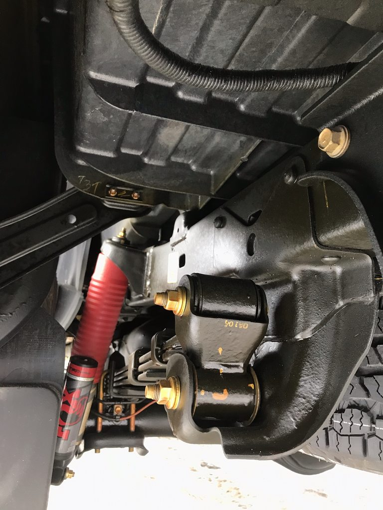

Black cosmoline on rear axle housing and 3rd member is looking snazzy
I did a thorough respray over the old that had weathered to dull after a year
Maybe this year it stays black and sharp back under behind there

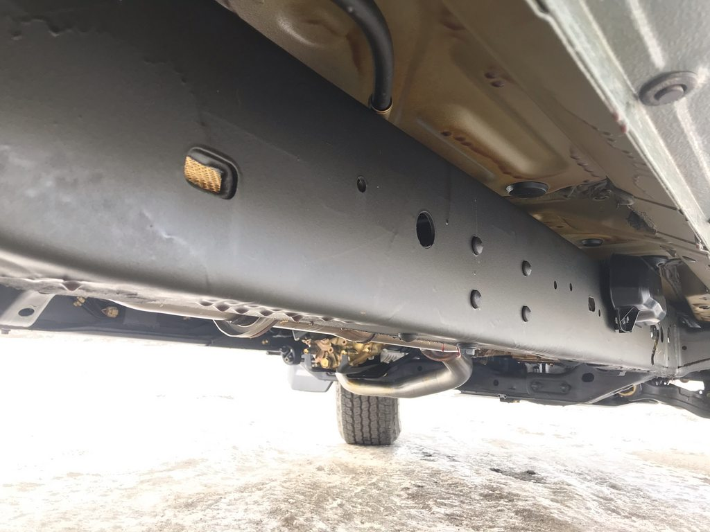

I probably need to hit my trucks frame again this time with that black stuff. With the rainy weather, and all the road salt, and brine the trucks been exposed to, the existing amber cosmoline I'd had done well over 3 years ago, has now turned the frame a light gray color...a dirty white in some areas.

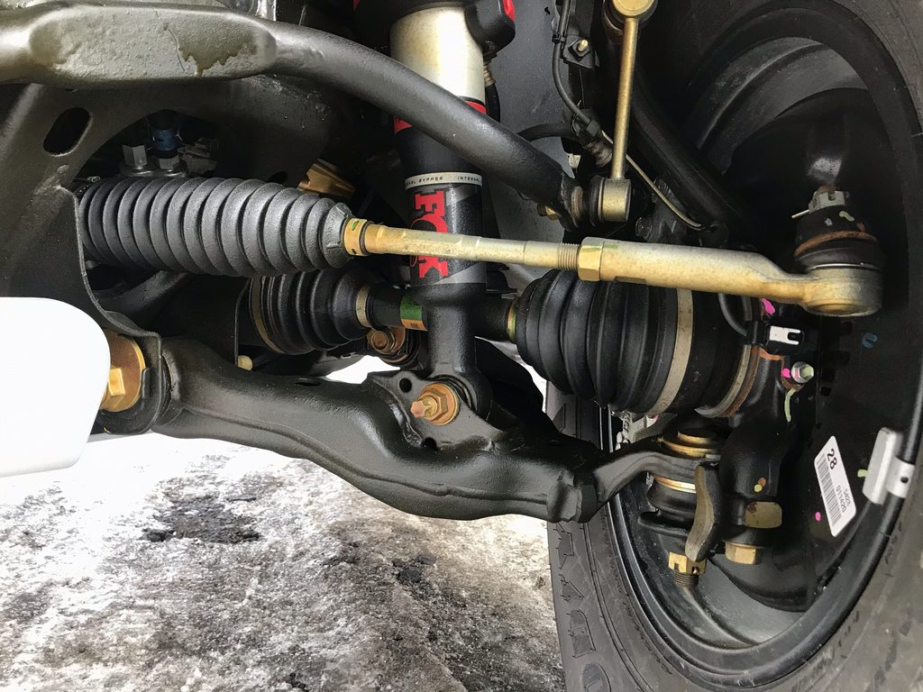

I've used lanolin based fluid flim here in new england, and it didn't last very long on the tundra I had. Switching to cosmoline on my tacoma has been much better requiring only minor touchups in the rear wheel area for the 3 1/2 years since applied.

They used the amber cosmoline, same as I did. That frame is the exact condition mine was for a couple years till it got really dirty. All the hardware is coated in that picture same as on my truck. Thats just the way amber cosmoline appears. That pic of the cosmoline on a new truck frame has probably been done within a year.
Possibly so. But the label on the front brake shield is pristine as well as the wheel weight next to it and the inside of the rim.....pristine.
