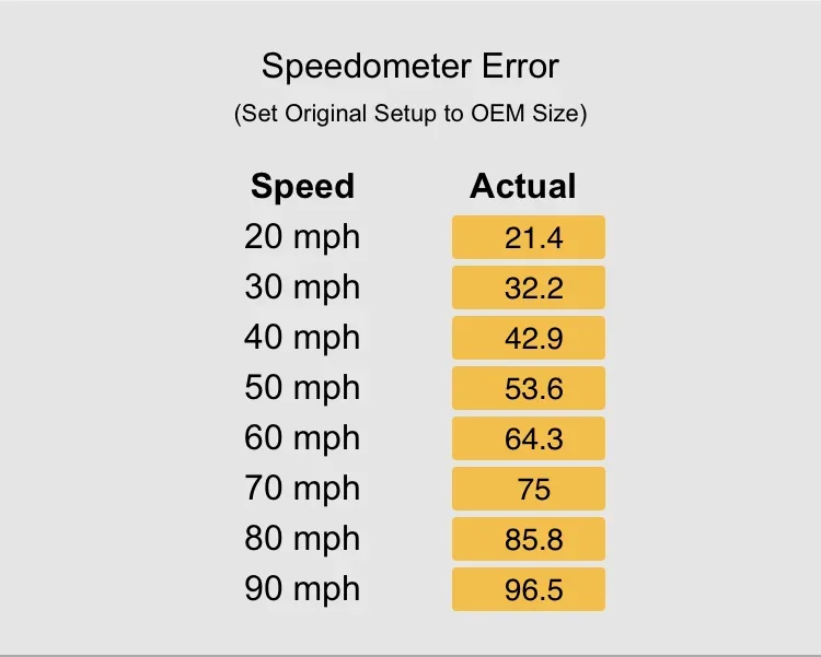

Look at the 275/70/16 KO2's. They are 1.8% bigger and are C rated. That's 1.8 mph off at 100 mph. Basically nothing. I think that's what I'm going with soon!
Is there a way to fix the speedometer to read correctly after putting on bigger tires?Good choice on tires. 265/75/16 is the largest tire on stock. You’re going from 30.6” to 31.6” so your speedometer will be off by about 3 mph at 70mph your actual speed is going to be about 73. Around town it’s not going to be a big enough difference to notice. Any time you add a larger heavier tire your MPG will suffer some. With that upgrade you may see up to a ~2mph decrease in mpg from stock. Stay with 265/70/16 if you want to keep it stock.

Ok cool. Thanks!It’s really not enough of a difference to warrant the cost to fix it. If you had 35” tires it would be a 10mph difference at 70 mph. That might warrant the change. Just do the speed limit and you’ll be good.
265/70/16 vs 285/75/16
Speed displayed vs actual speed View attachment 14096
