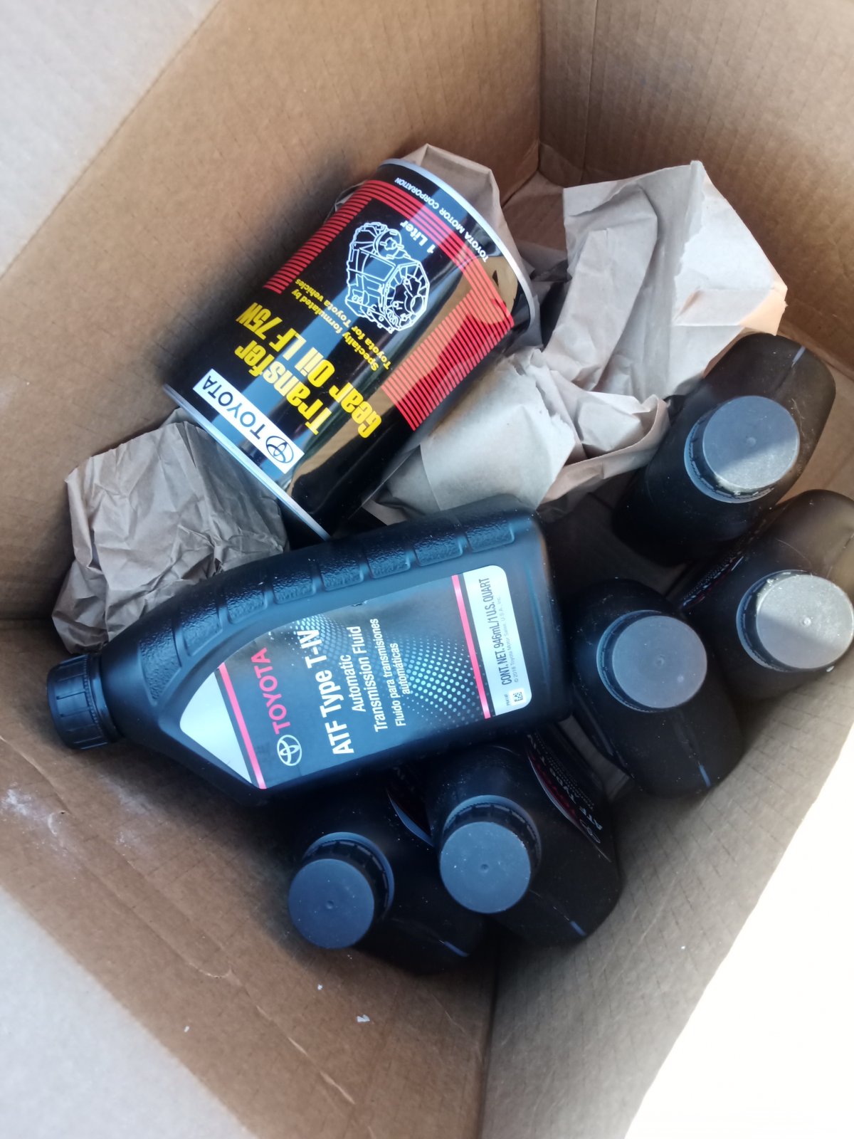

Well.... you have enough ATF for 2 drain & fills. Barely enough gear lube for the Xfer case. Definitely, not enough gear snot for rear and front diffs.
No matter, they have a long shelf life.
