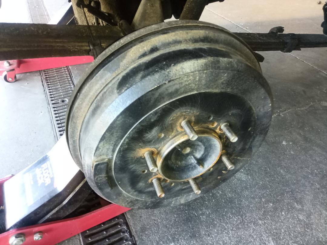

brake drum gasket?
Hopefully that gasket will making removal easier after the next 110k miles.:D
it's stucken stubborn elsewhere too! Around the outer edges
I did put antiseize around the hub area that the gasket doesn't touch on the lip
Now I must order up a bunch of new parts for the handbrake and tear it all out
Not sure how it got all that rusty crusty inside there :oops:
after checking the carFax i must update that 110k to 137k miles since the drums were last off the rig to powdercoat for aesthetics
i have not yet been able to find if i took a pic then of the internals to compare that bellcrank lever mechanism to see if it was all that crusty then getting stuck or if just happened over the past several years

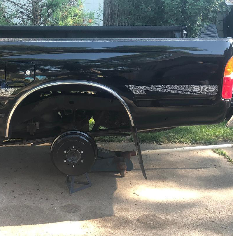

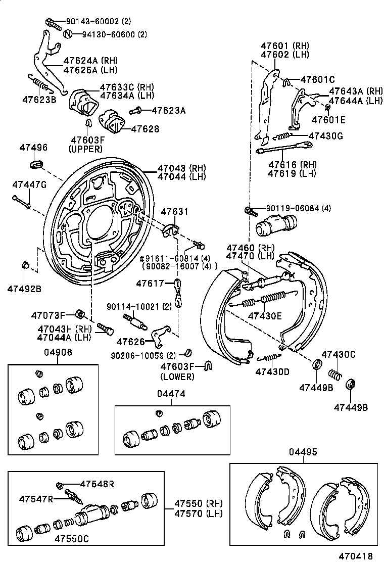

and Yet the parts diagram shows my rig as having a gasket in the rear drum area :eek:
With a part# even
I queried to timmy the toolman Toyota time YouTube presentation and he also was curious about this gasket and none of the numerous rigs he's done the brake drums has ever had this paper gasket on there
next up will be attempting to remove this drum on the passenger side that is likely seized on there as well :mad:

part 47628 on the diagram for the aluminum bracket getting for the sticky?
