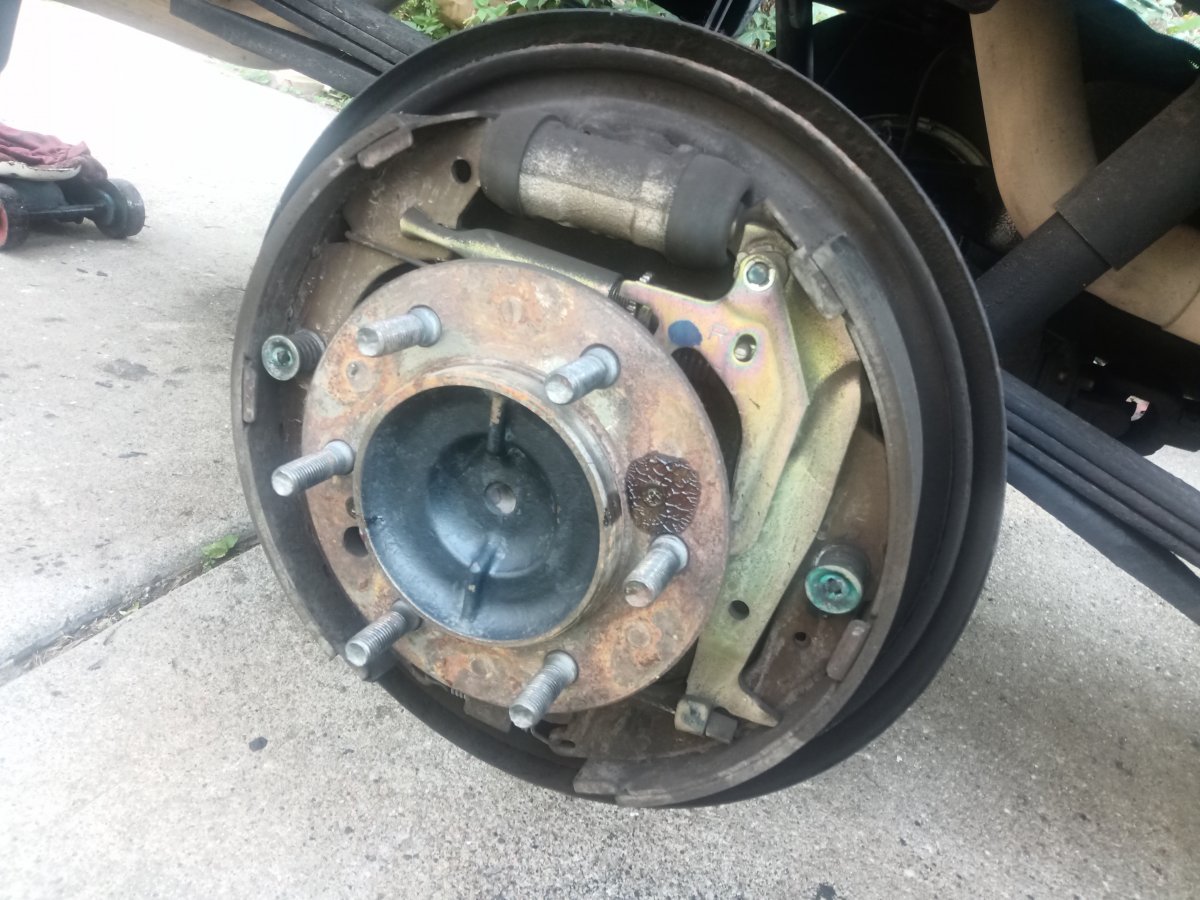

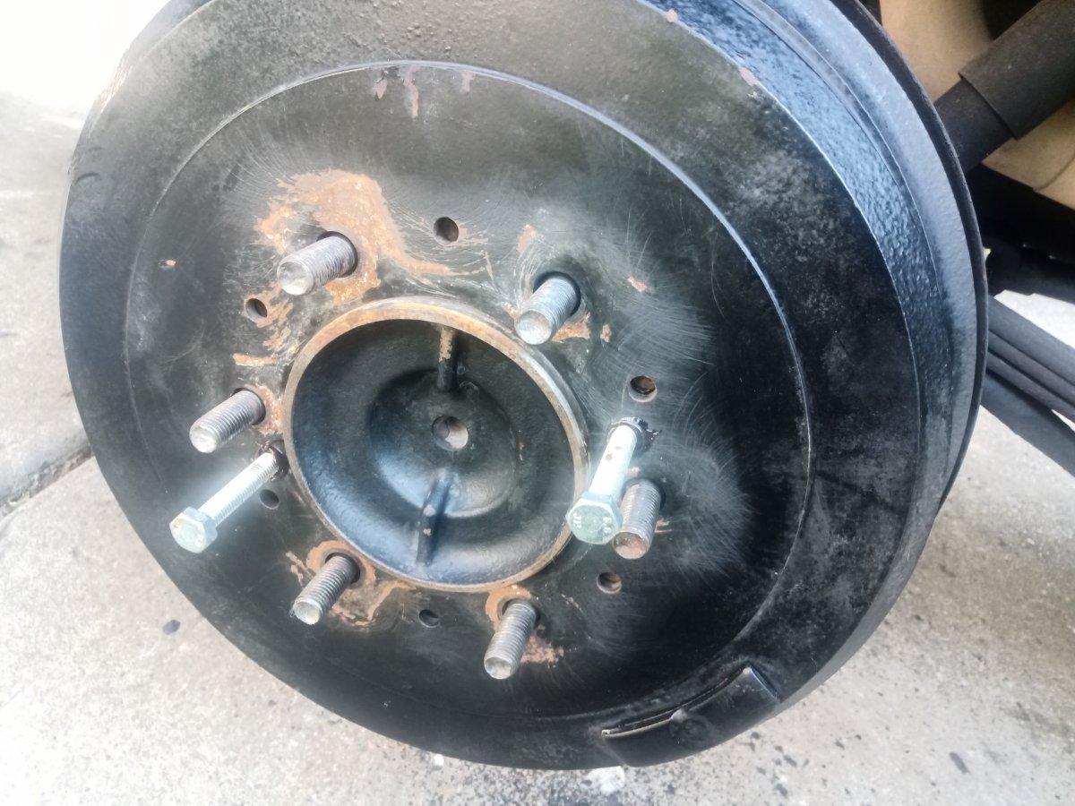

attempting the passenger rear drum removal
they tried everything :eek:

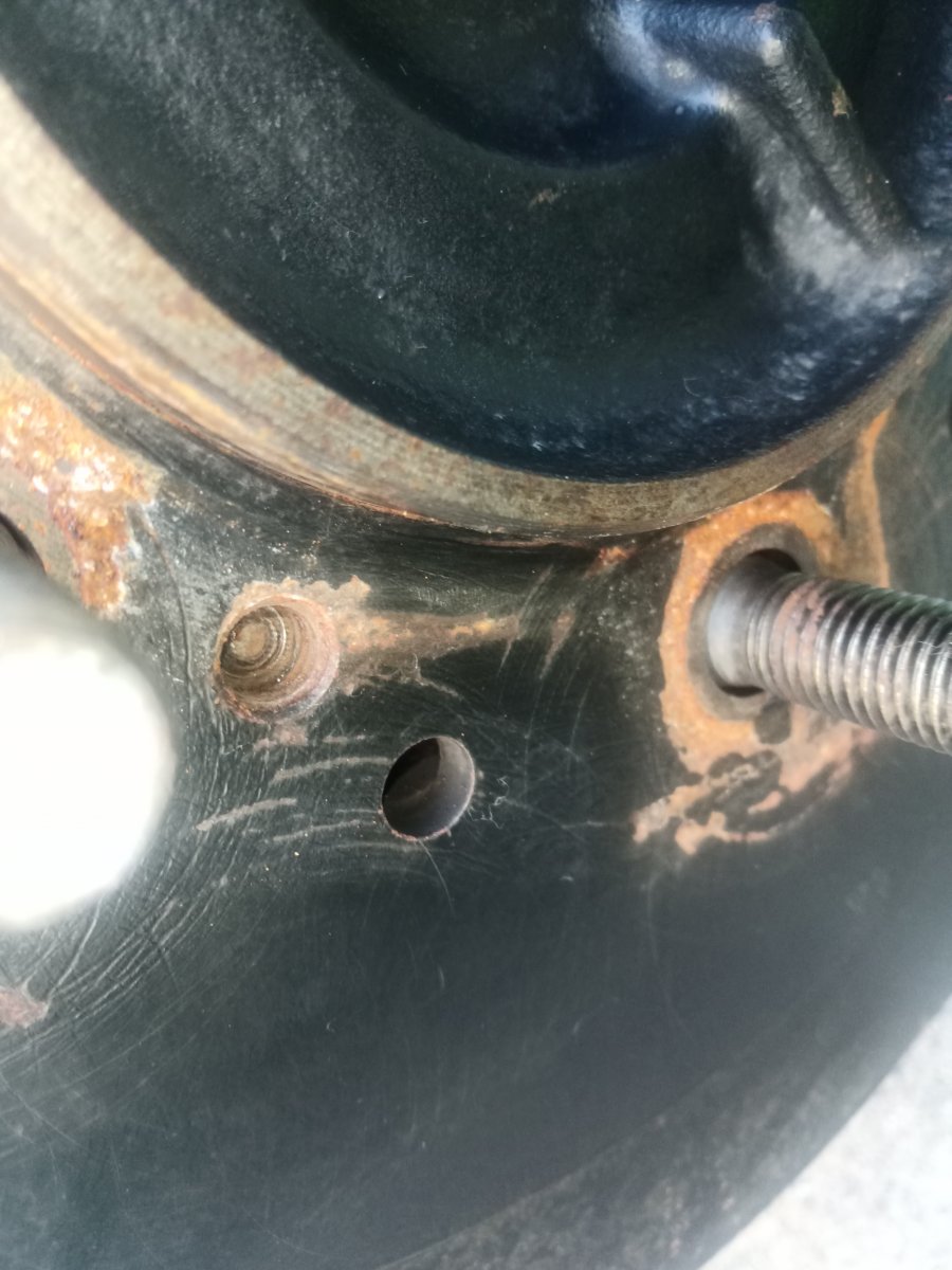

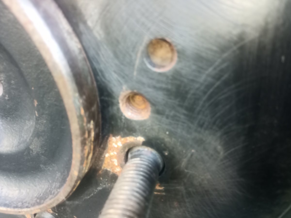

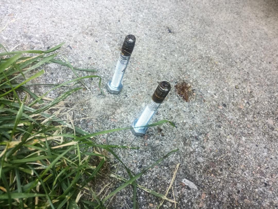

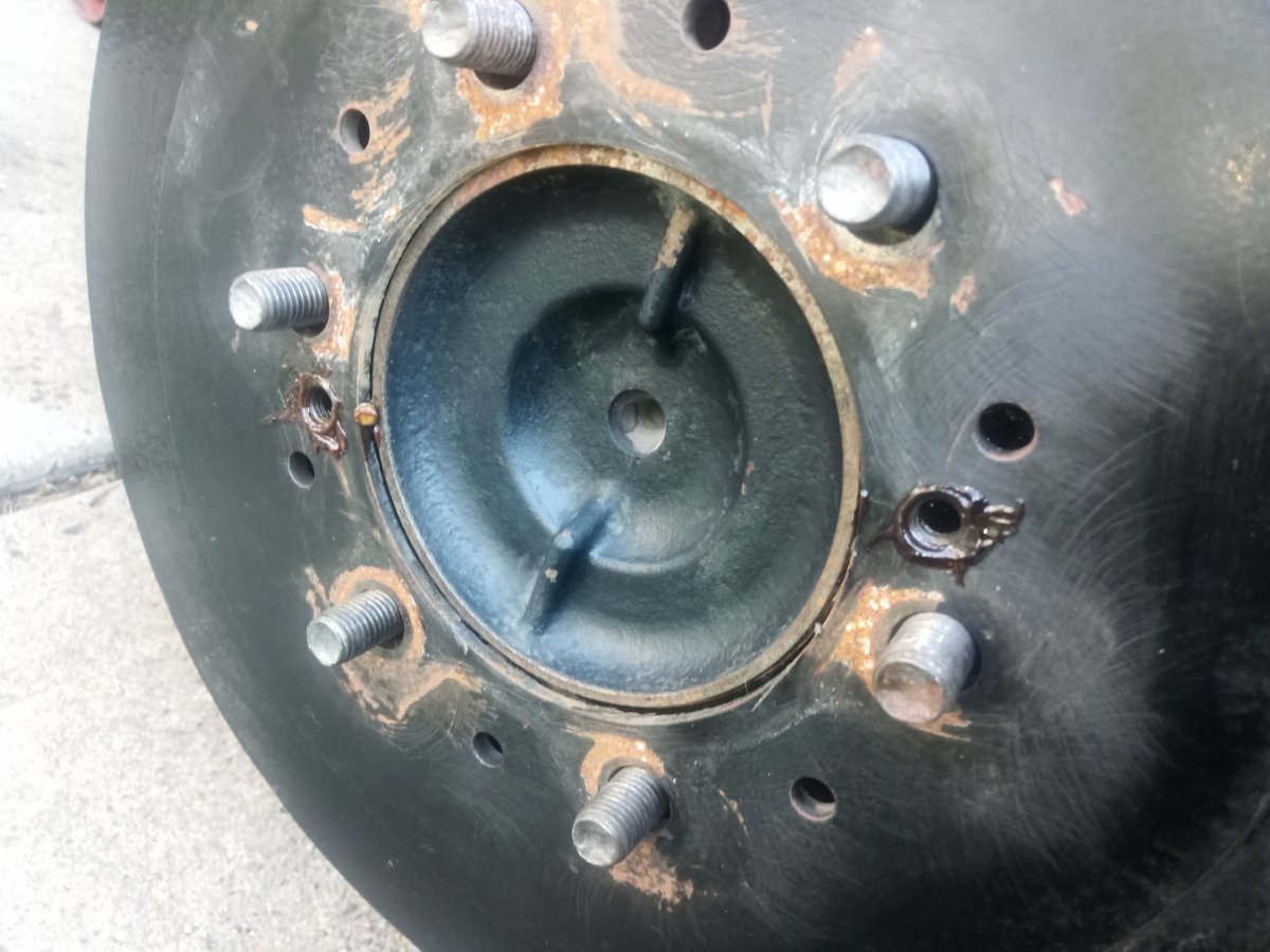

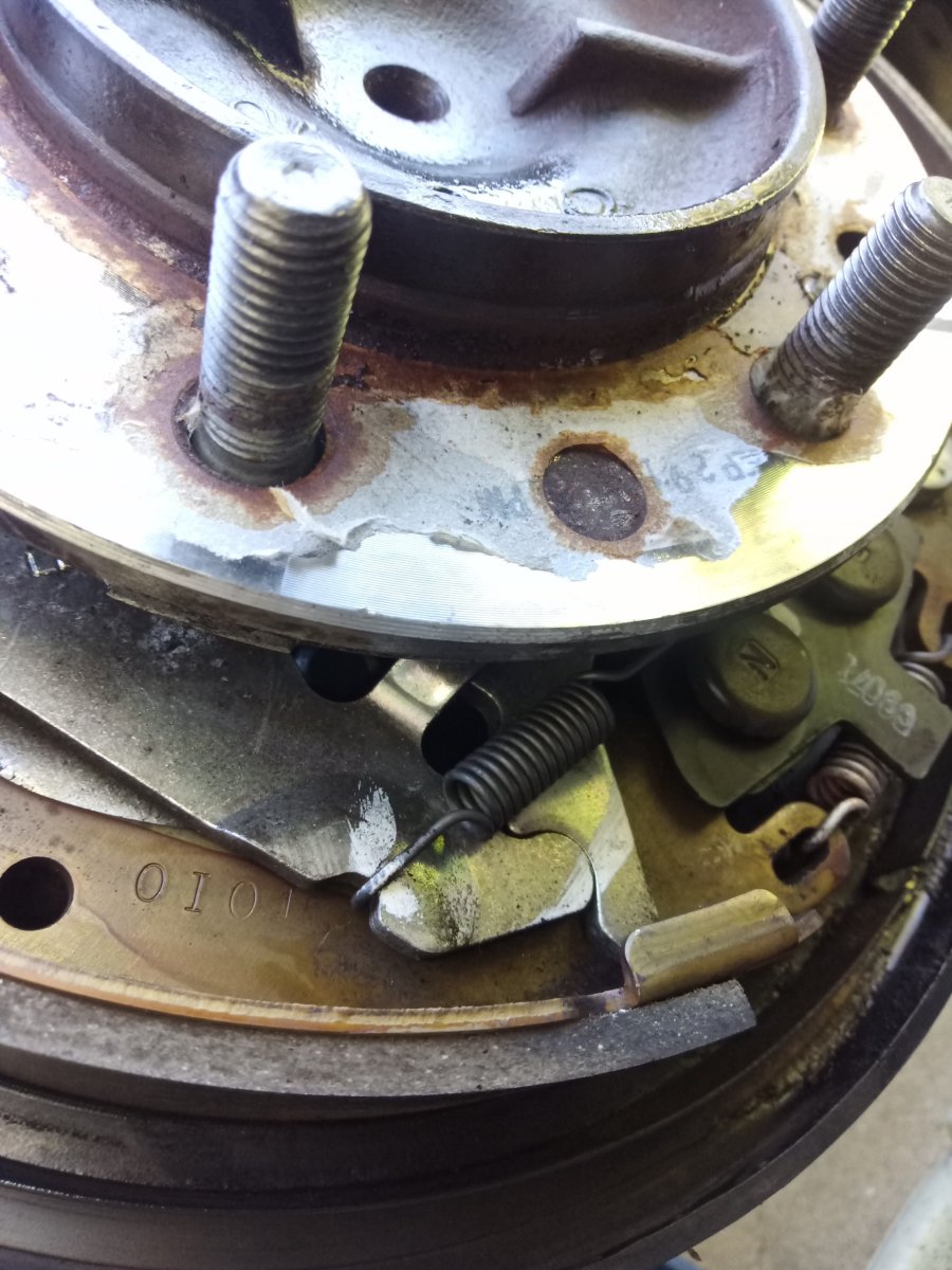

While bolting off slowly, something popped behind there
Pushed drum back on, tapped around with the rubber mallet and gave it another try with the bolts and much wiggling off
Finally, the 4th try did it
The gasket is missing LOL

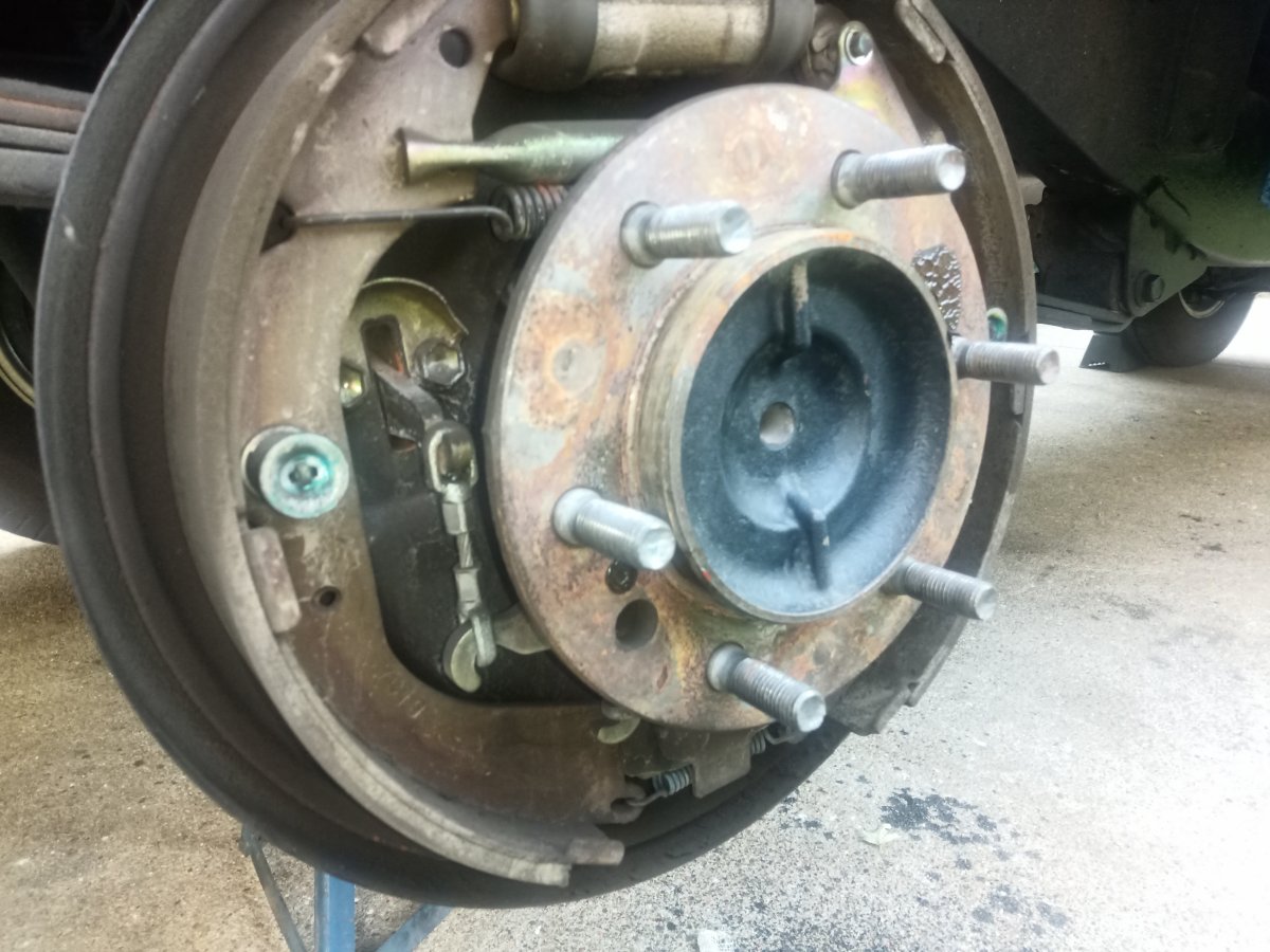

Inner drums
Inner drums

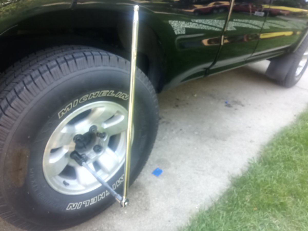

Brings back memories of me jumping down on a 4' 3/4'' breaker bar trying to loose all the lug nuts on my tundra when i went to rotate my new tires. I have no clue what this tire shop used to mount these new tires back on my truck i brought it there. I think i use every cuss line i knew.
LOL 4 foot!!!

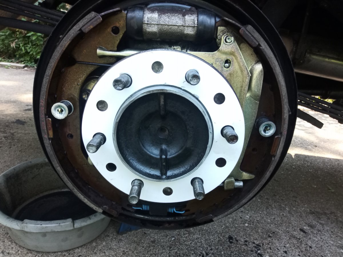

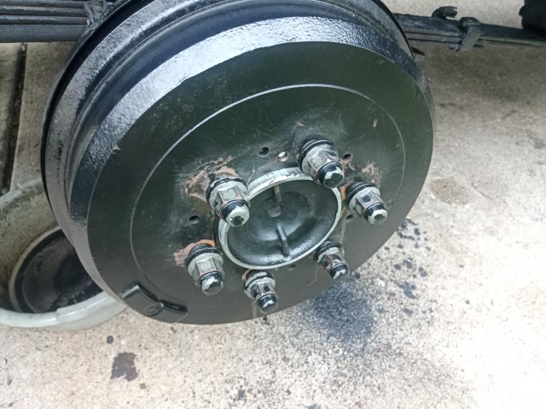

covered up the studs like this because it rained all night long,
did not wish to have to re-clean them

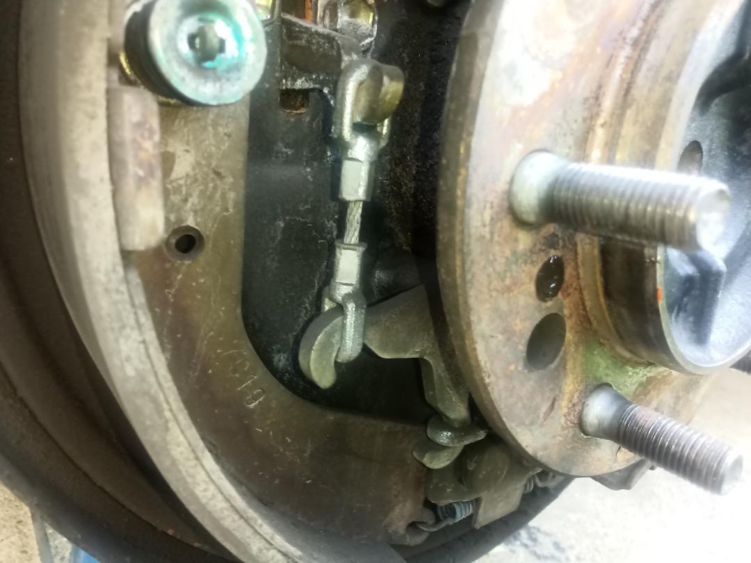

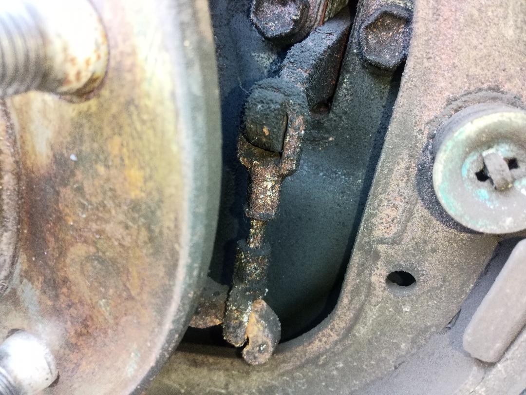

i don't know why the driver side has more weathering inside (compared to passenger side) on this area
other side

View attachment 34071 Should of just slapped a trash bag over it.

My gen1 tundra looked like that to. Those emergency brake levers would always seize up no matter what i tried.

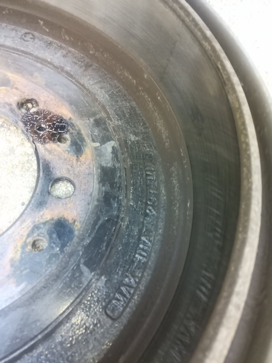

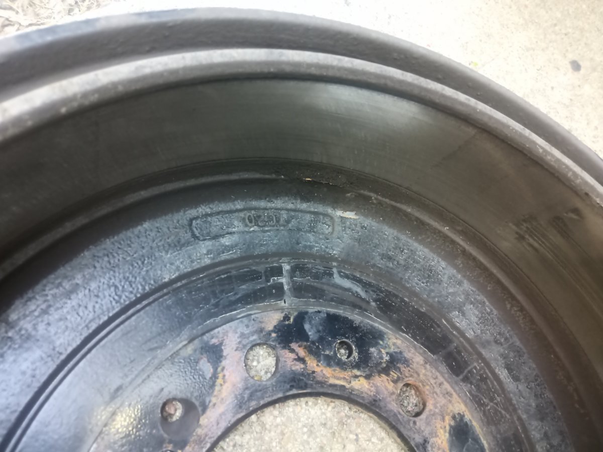

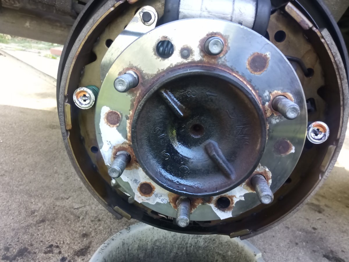

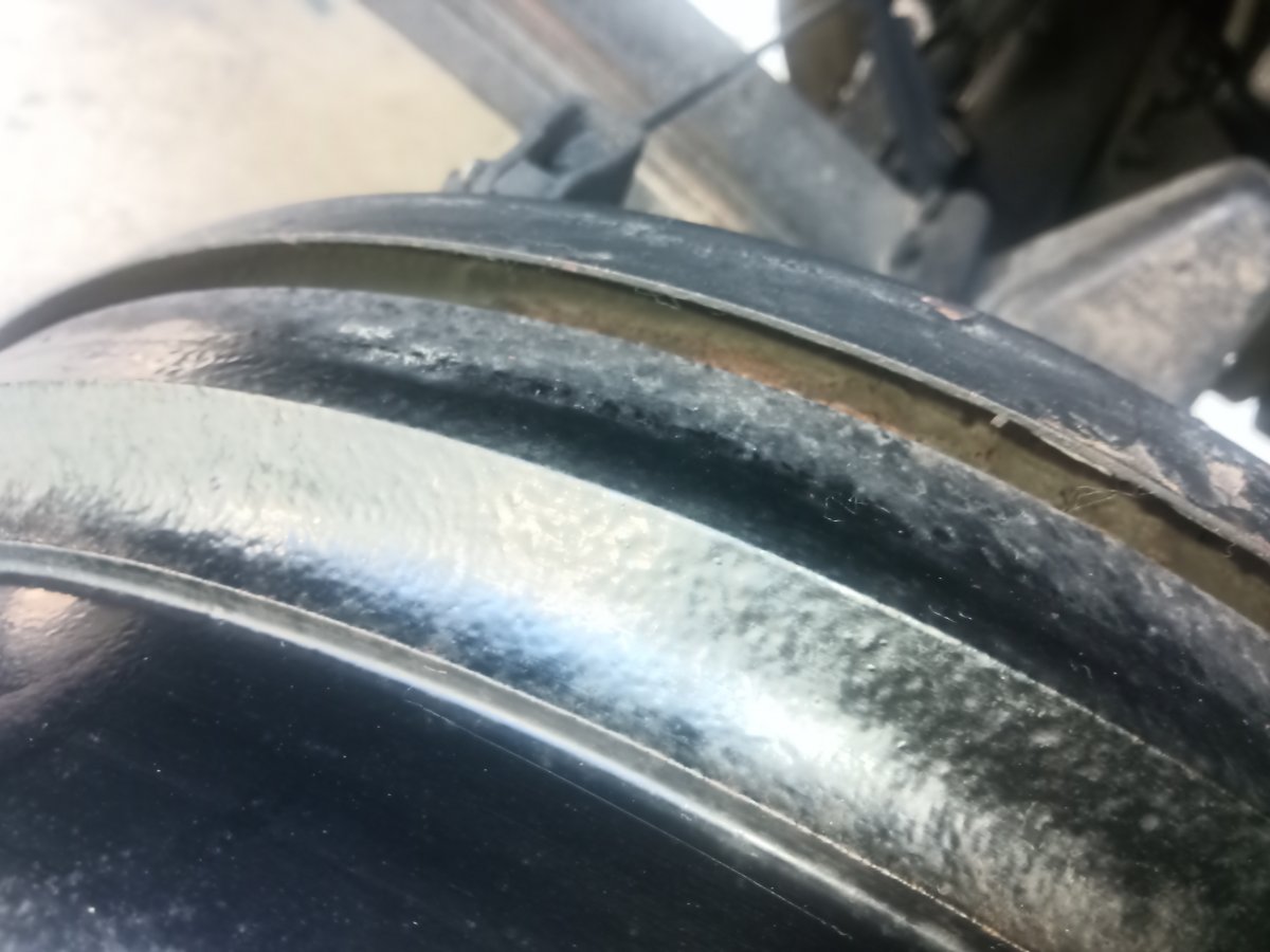

removed drum from relatives 2o11 taco, probably first time in ever since the drums were seized and I tried EVERYTHING tic tic
Used those pry bolts and the mallet and the sledge since these aren't coated but are crusting a bit
Remnants of that paper gasket were found but most of it was worn off in 11 years and 66k miles
