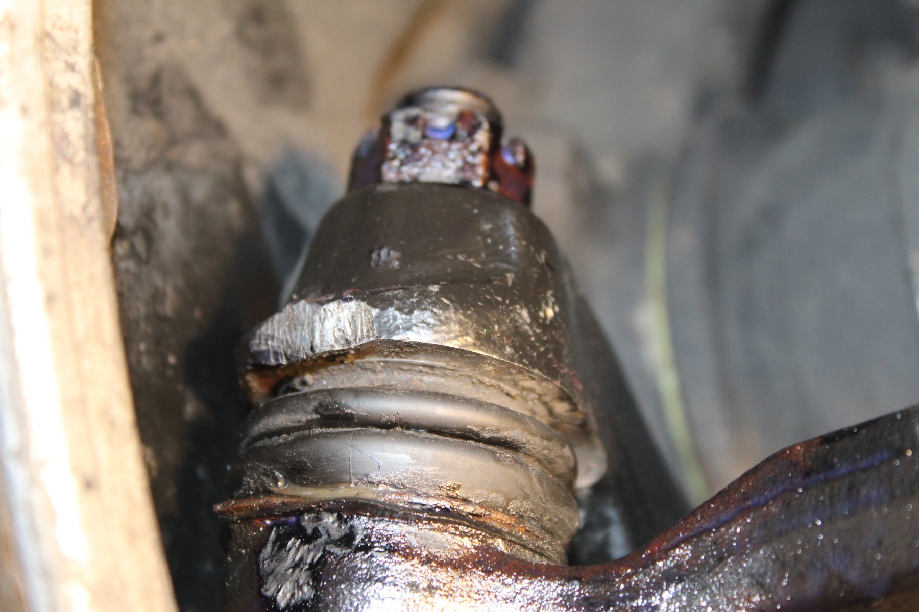

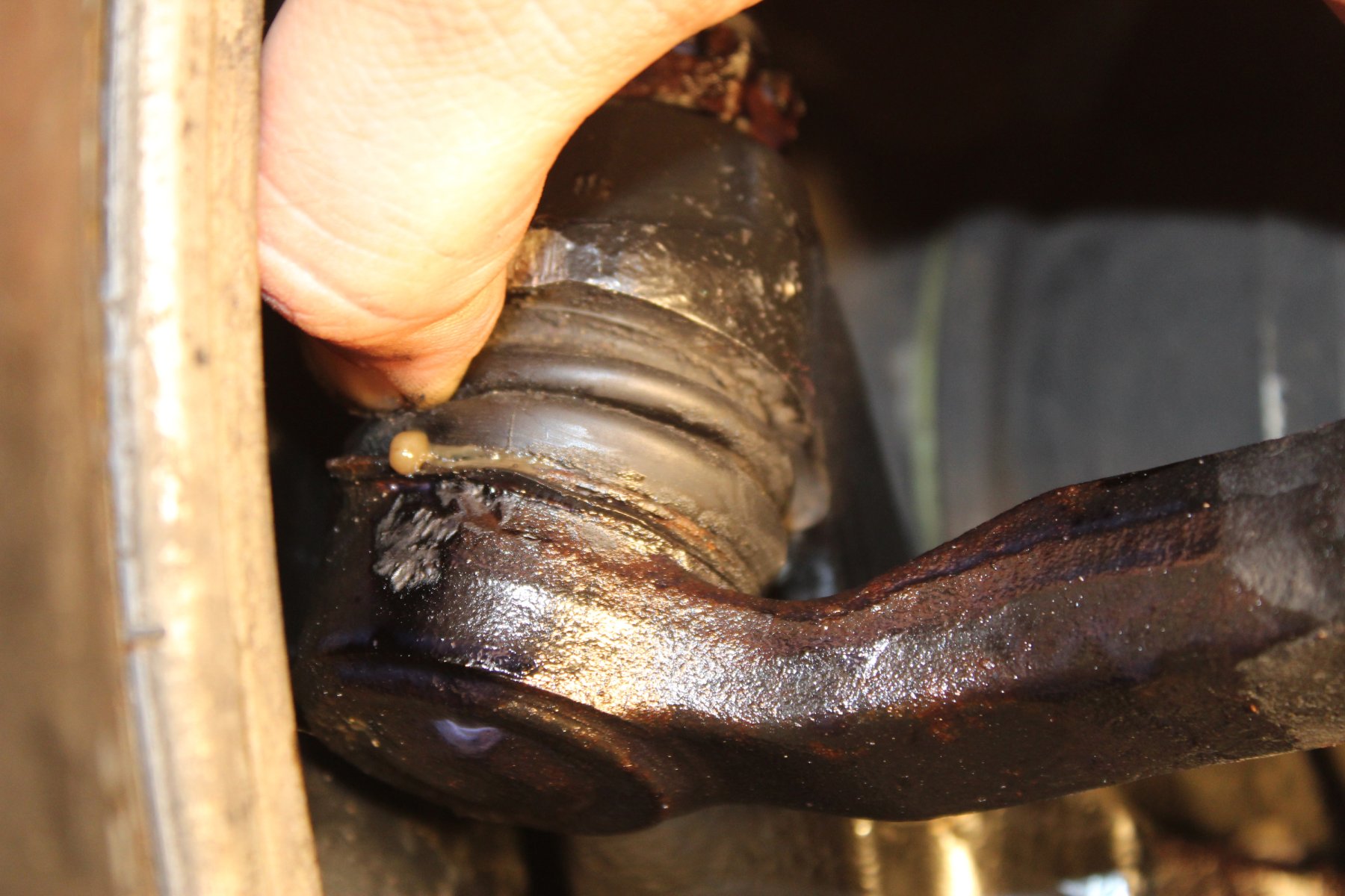

i know one of the outer tierod ends on the driver side has a weep from the boot getting hit with a hammer and split, i have not noticed any leaking grease on the other side
i thought that the sign of shot tierod ends would be louding clanking/snapping when you turn wheel, especially a full turn? this is not the case you say
here's a pic from 15 months ago of the driver side after that wheel bearing was redone

Those are different than the outer tie rod ends my 01 tundra had. They look beefier. If no slop in them their ok.
FireStone and one other Toyota tech said there is looseness in the inner tierod on driver side
but not sure exactly what they are talking about since they do not provide me with a closeup experience to my own property which irks me
