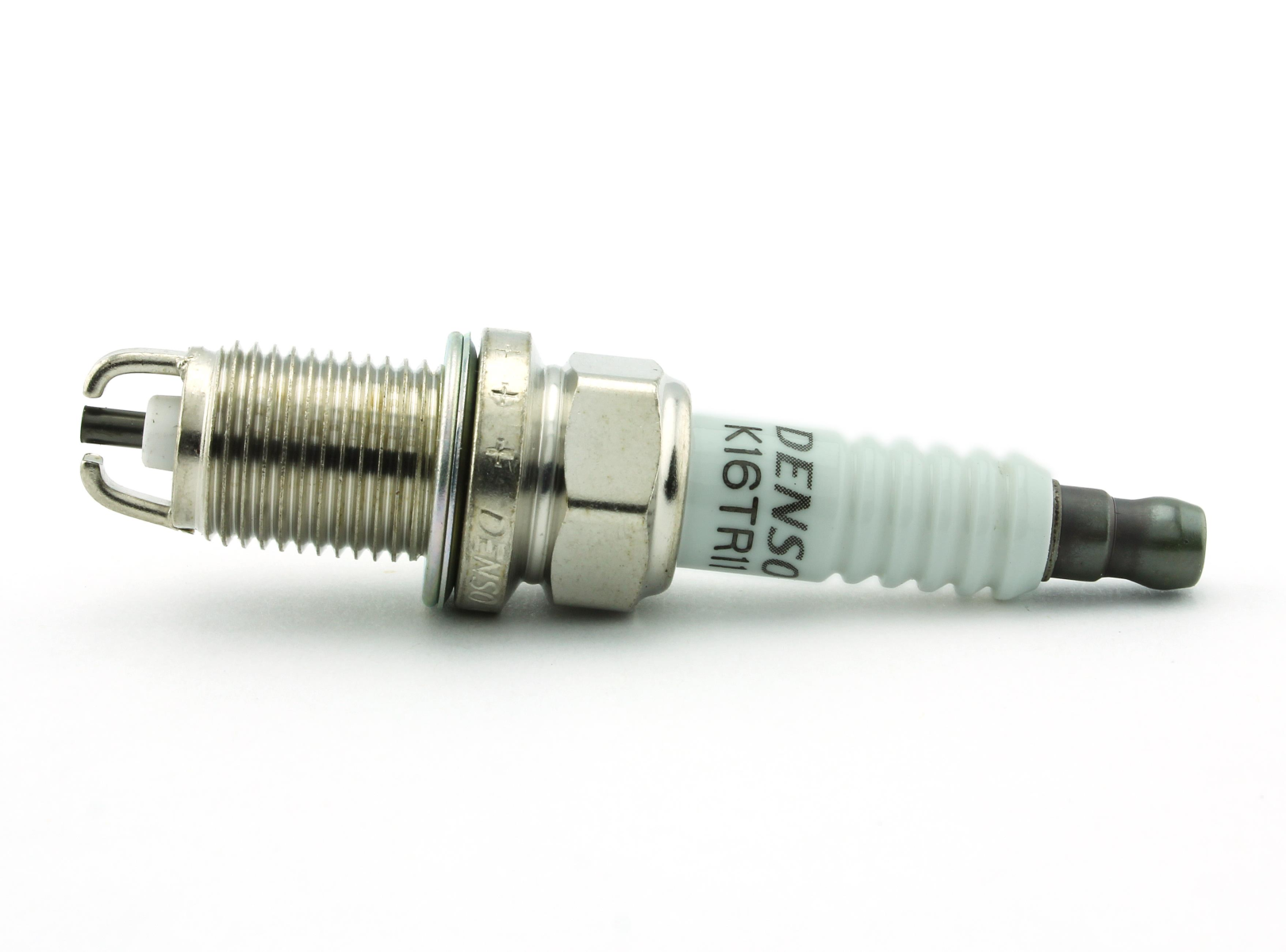

Genuine Toyota Spark Plugs:
  • All resistor plugs with single ground electrodes feature a patented *U-groove design*, resulting in a hotter spark.
  • All *platinum-tipped plugs* are designed to last up to 60,000 miles before replacement.
  • For newer Toyota vehicles with distributorless ignition systems (DIS), replace your original spark plugs with the same *dual ground electrode* platinum-tipped plugs that came standard with the vehicle ù single ground electrode plugs offered by competitors will only last one-half as long.
  • *Tip*: Be sure to check to see if there are platinum or iridium spark plugs available for your vehicle.
  • *Iridium* spark plugs can last up to 120,000 miles!
  • To ensure the most trouble-free operation of your Toyota, please check your vehicleÆs Scheduled Maintenance Guide or consult your Toyota dealer for proper spark plug change intervals.
IIRC, the 4 cylinder use the dual electrode. The 6 uses a single electrode. This may only apply to Gen2.
Either way, please consult your Owner's Manual for the correct plug for YOUR truck.

All i know is what happened to using the cheap $1.50 ngk plugs in their older trucks?
Well.....they aint a $1.50 anymore. A candy bar is about $1.70.......
I use the basic copper Denso in my 1FE-GR (4.0L V-6) Gen2. They cost about $5/ea at the dealer. Funny thing, the dealer cost was less than the Auto store. So, $30 + tax and about 1 hour of my time. NO reason not to service every 30K. I spend more on oil changes in 30K.
