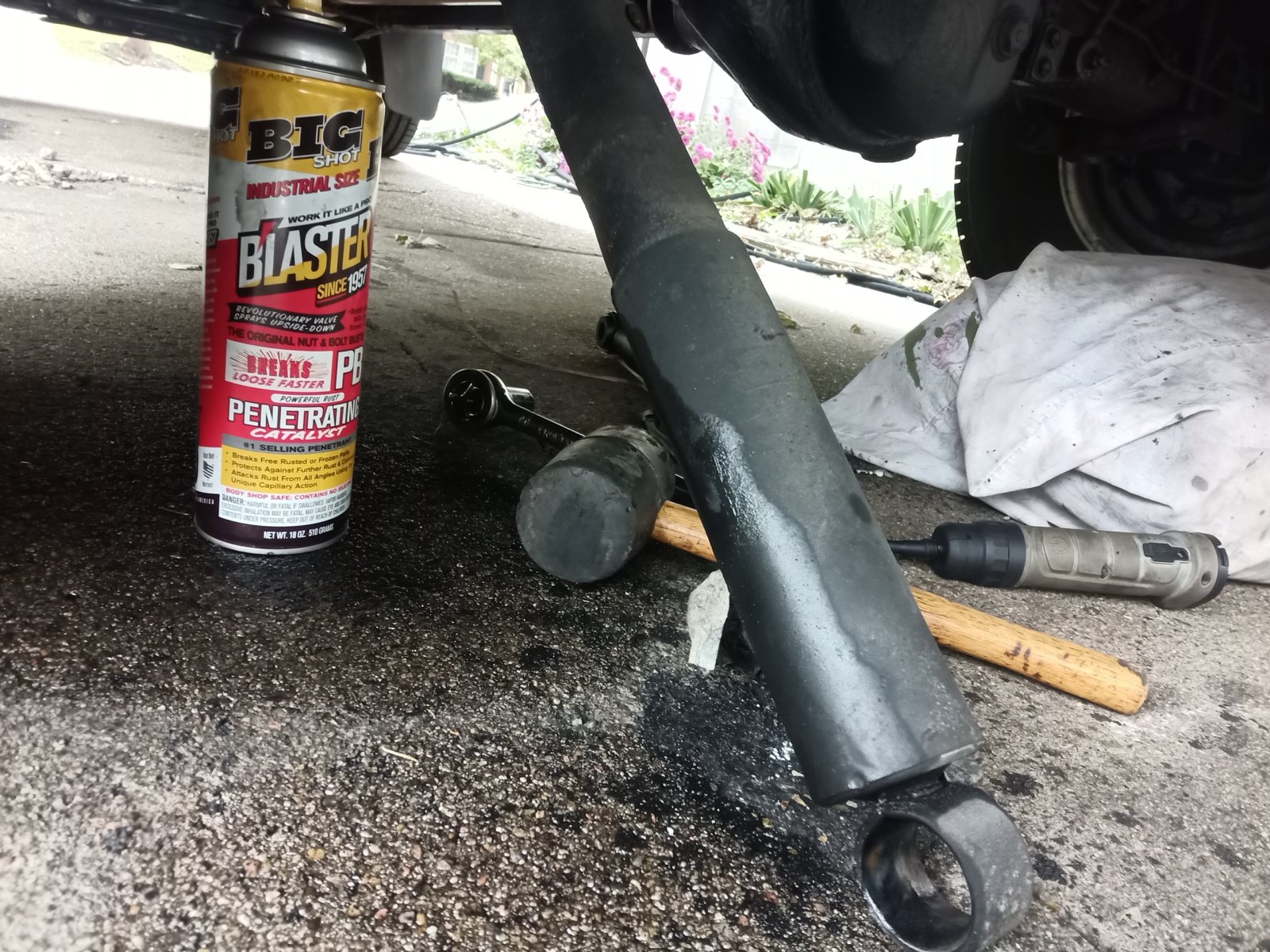

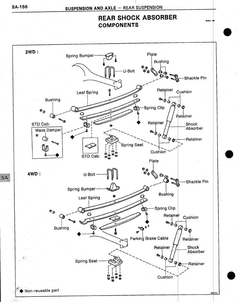

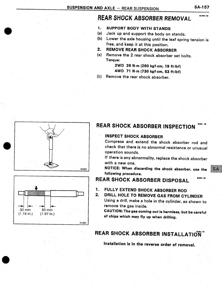

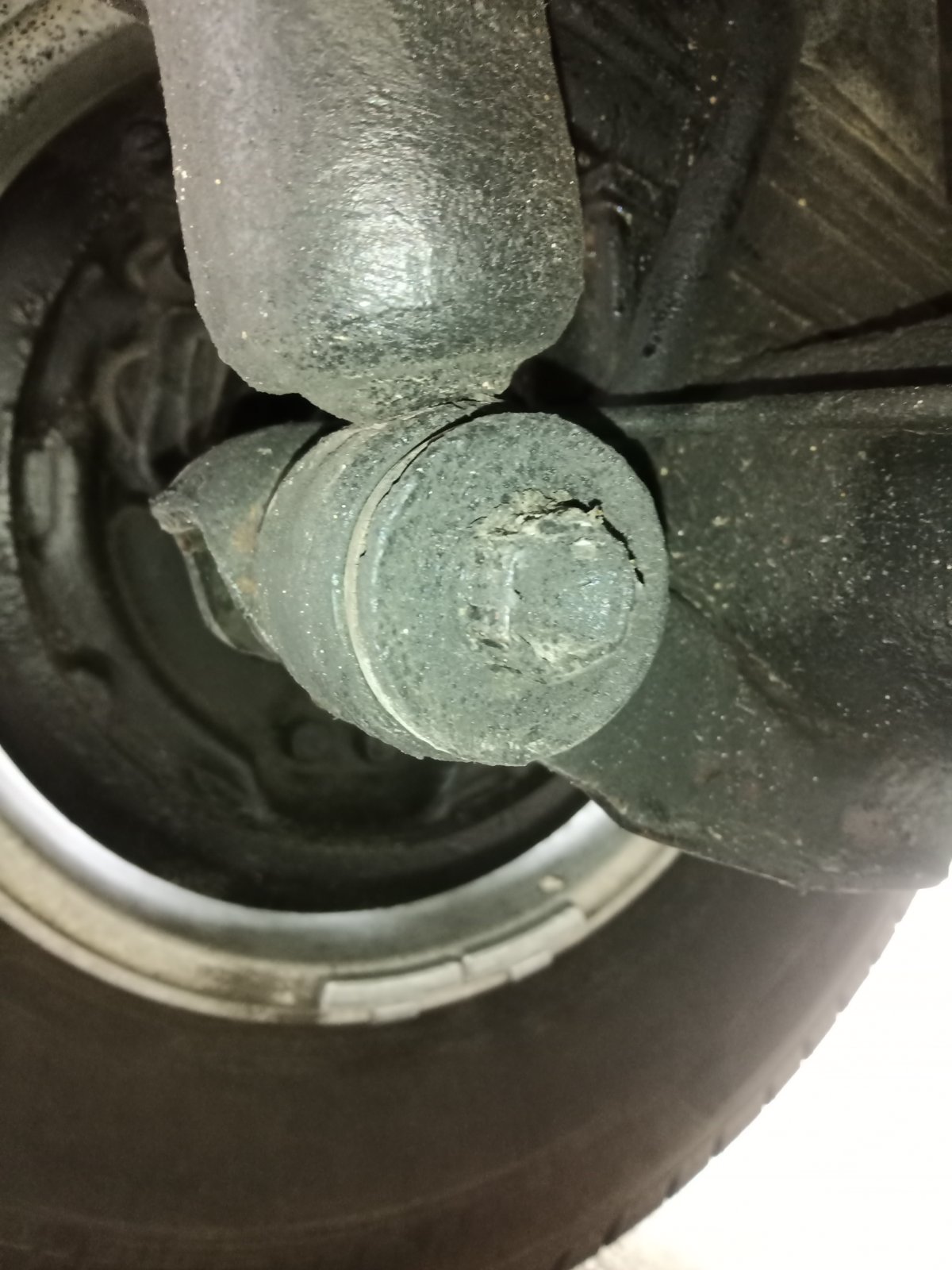

after some research it seems i can get them off the back with spare tire delete and no need to raise truck off the ground and release tension in the springs, as the FSM instructs to do so

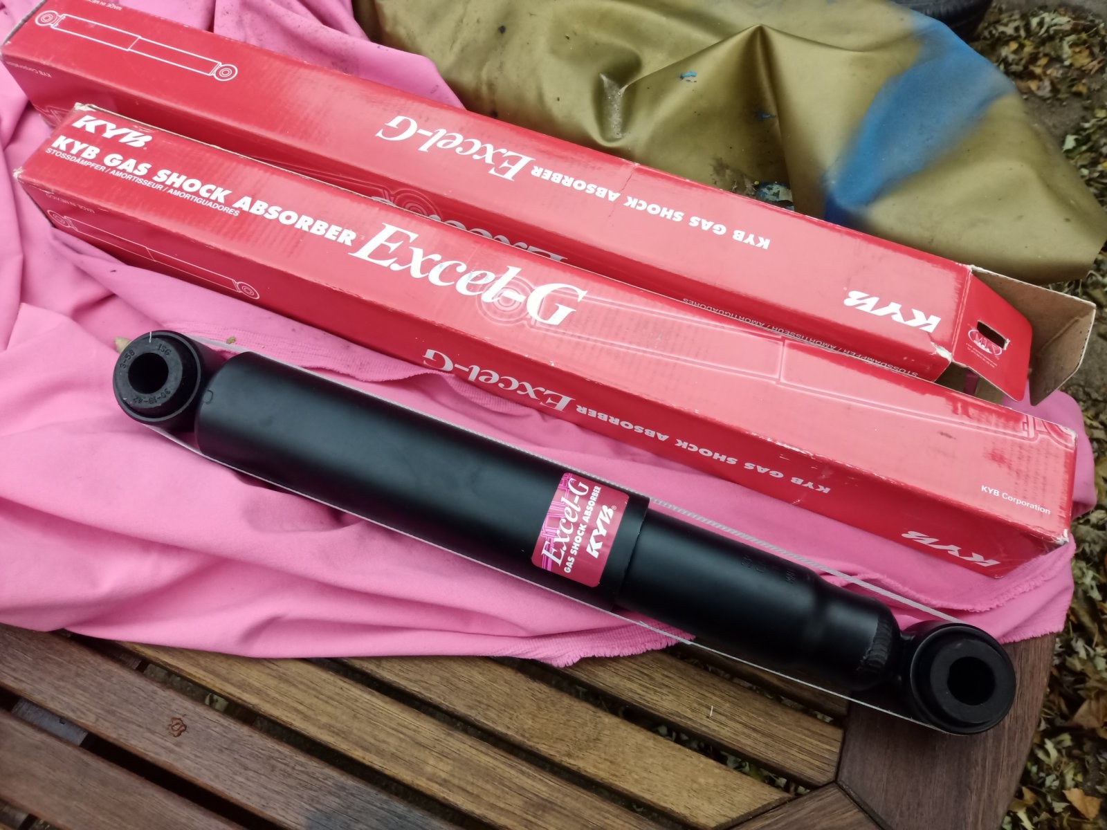

KYB is wot i was sold @ AAP
17mm

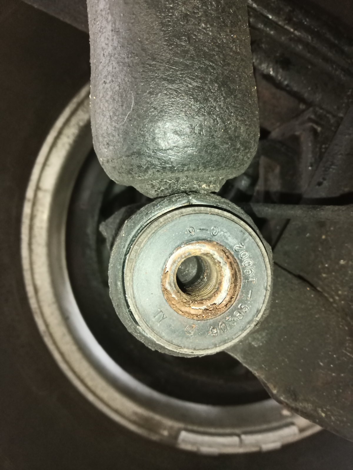

WoolWax coated for couple years kept rust off 'em It appears... or perhaps not as seen later
Now the pickle...
The new kyb are banded to prevent expansion but with truck on ground they are not long enough to just slip on and cut the band :confused:
I am not confident that my left bummed shoulder can muster the effort needed to squeeze it to for it to just slip on there
So far so good it is :D
Came off smoothly with a couple gentle taps of the rubber mallet

Throw a sheet of cardboard on the concrete. It'll give a bit of a cushion and some insulation.
Use the floor jack to raise the axle. I assume the truck is on jack stands. You can cut the retaining strap. The shock should expand slowly. The strap is used for shipping purpose.
Save your shoulders and muscles.

No, it's not on any stands! I read it can be done on the ground relatively easy

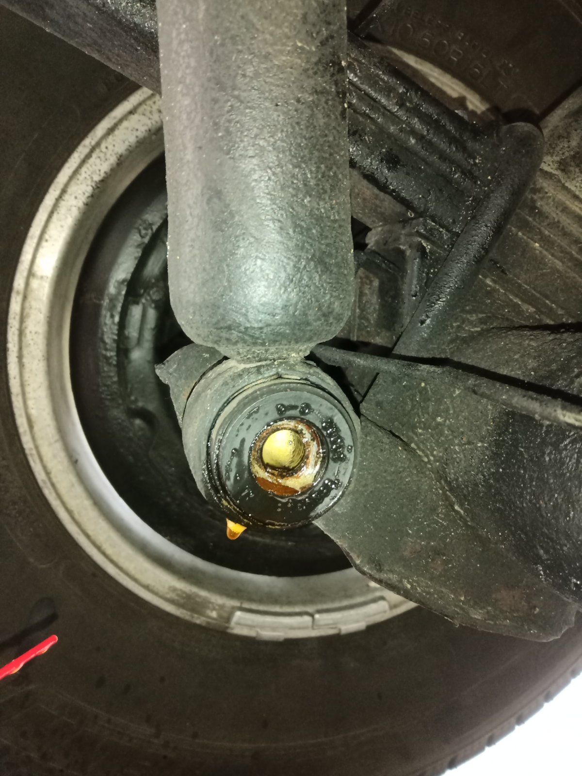

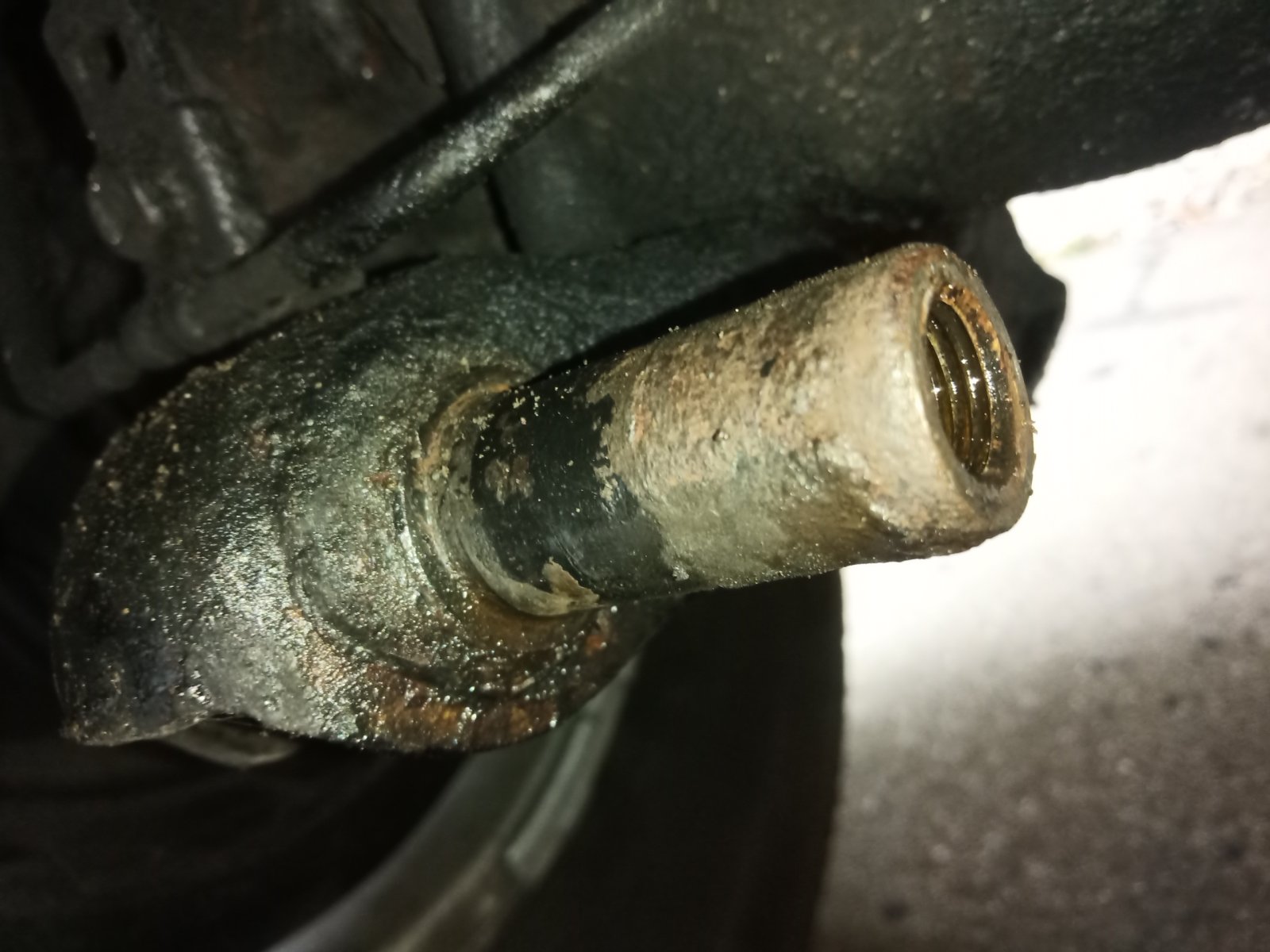

I've seen horror stories on youTube where they are welded rusted rubber melted on and have to use pry bar and take wheel off for a better angle from the side
Thank goodness this was not the case here!

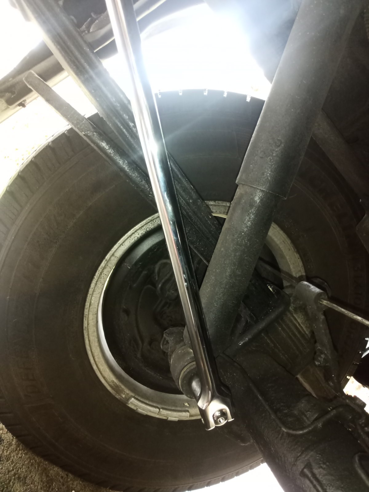

It took a spell to get the passenger side one off
Had to get cramped under muffler and shaft to go up and over for the top bolt with a 10 inch extension on that breaker... then it needed a few more taps with the mallet than the other side did

good grief! these washers are 6$ after discount, 8.85 MSRP
the other side is 3.50 each
If the washers are in good condition, then why bother replacing them???
Rusted, wallowed out, bent, dished......sure.
