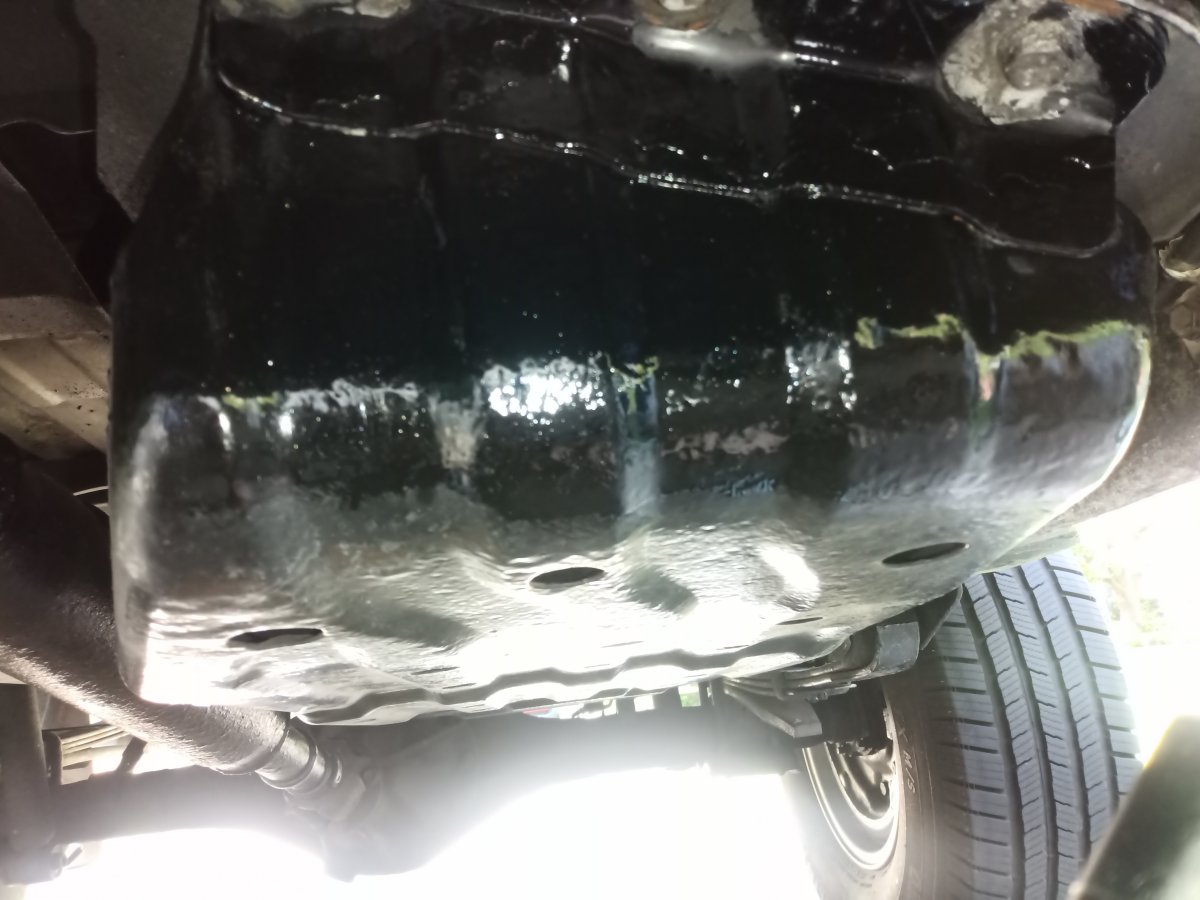

IMG_20220902_133441_124.jpg3yrs ago I thought that a good blasting and powder coating of the lower fuel tank shield was the way to go
Well that did not last long at all!
I noticed the peeling coat with rust under spreading fast...could be from road gravel chips
So I spread some EW converter on the roasty spots then a good coating over the spots with some extreme chassis gloss black paint
...Will see how that holds up over the coming winter

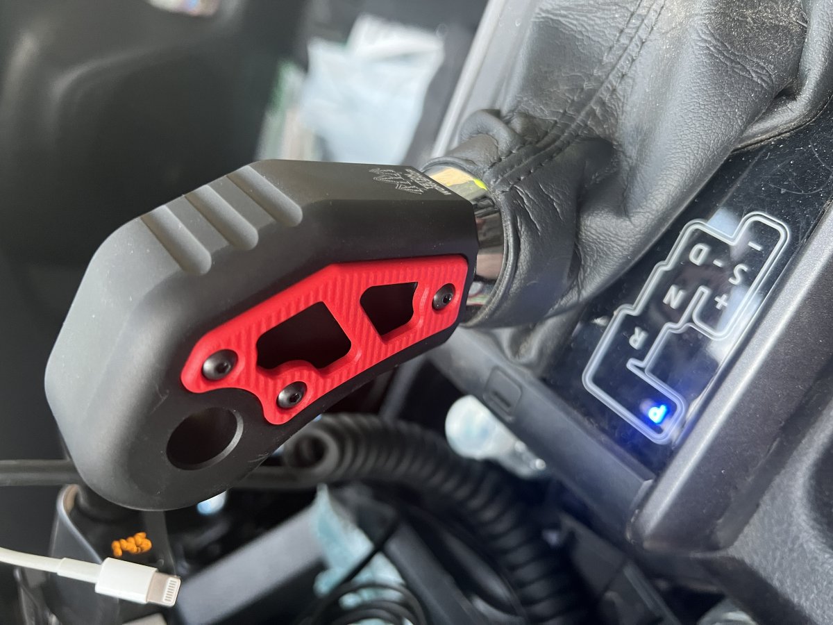

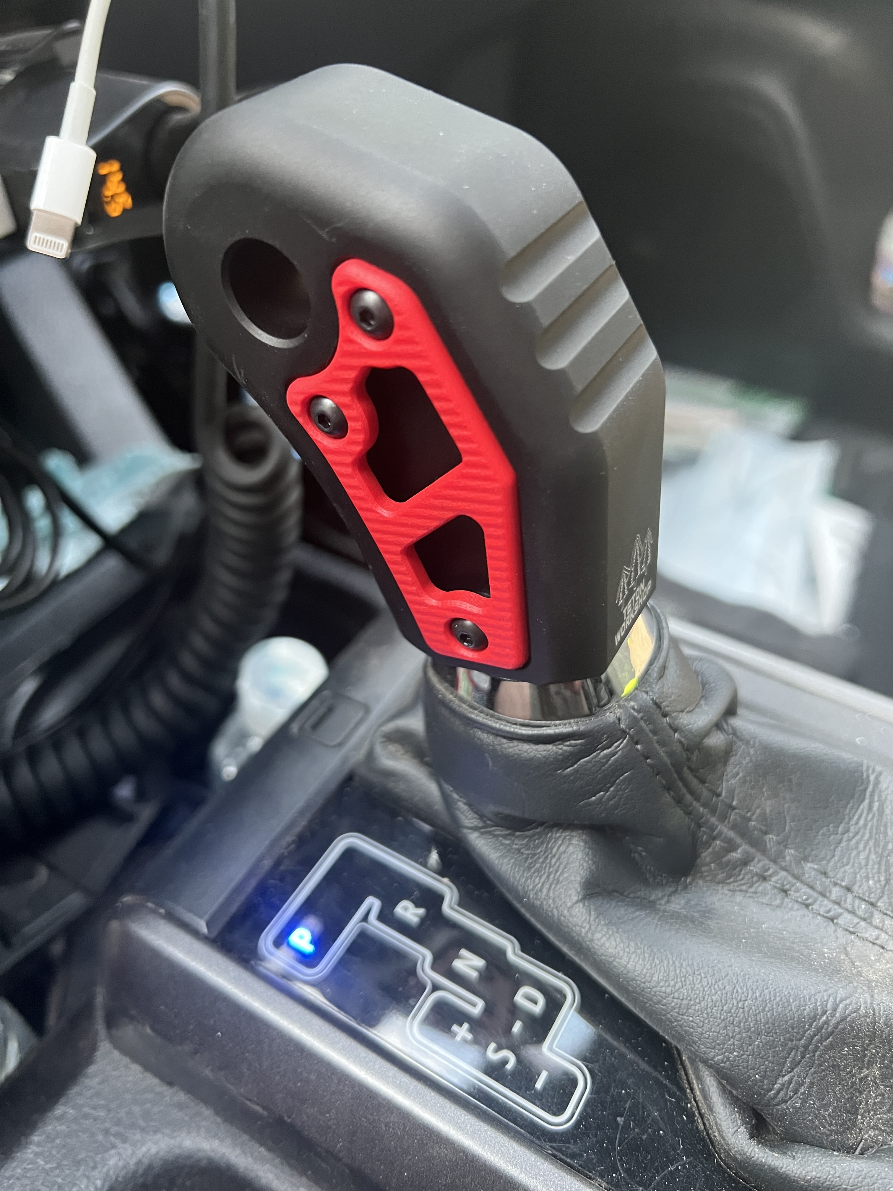

Added a Teton Workshop shift handle in red. This thing is badass...high quality, heavy duty, looks sick!
https://tetonworkshop.com/collectio...gen-automatic-design-3?variant=39983230582858

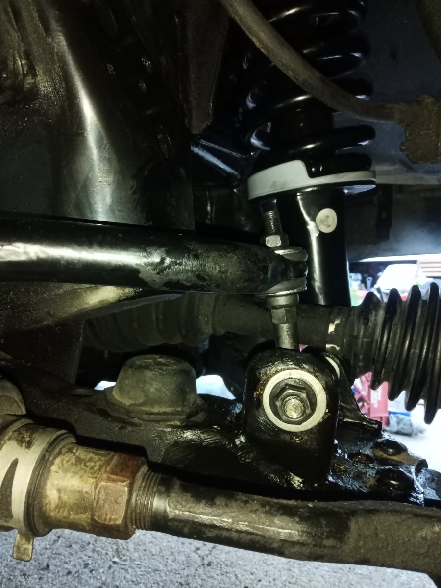

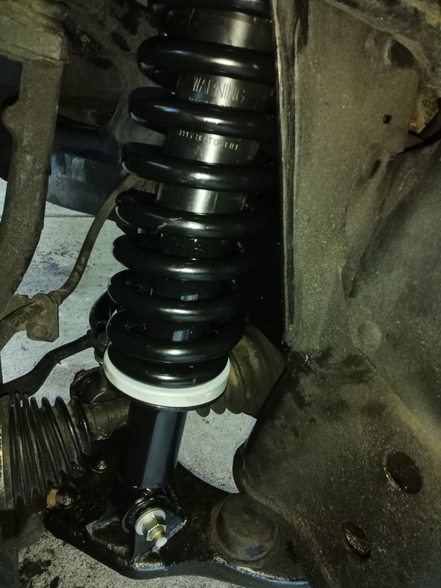

Trying some new Monroe quickstruts at 267k
Took strong nephew and I nearly 9 hours to do both sides plus some new moog stabilizer links
Ran into big issues on driver side that would not fit in kosher !!!
Refered to FSM on the coils disassembly/reassembly instructions and found the monroe factory installed top rubber insulator mount part was on improperly assembled :eek:had to get a rental coil compressor to turn the mount bushing to the proper orientation which took extra hours in all that mess... Not a happy tacoman :mad:IMG_20220903_185602_288.jpg
New moog stabilizer links with all the red tacky grease that fits IMG_20220903_190544_733.jpg
Wheels finally back on ground after a longish spell and all torqued up ready to test drive down them broken roads
:eek:

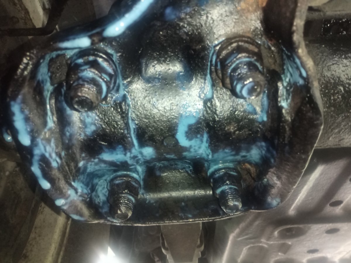

Attempting to deweather this area on rear axle
Using eastWood converter primer after removing a fair amount of dirt sand grease wax and some remaining loose coating
It's supposed to turn dark black when conversion done
Then maybe cosmoline it IDK

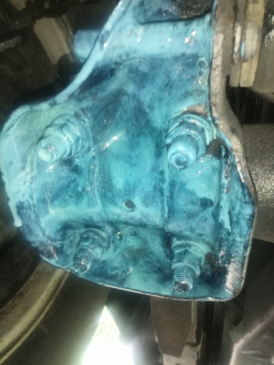

4wks later to finally deweather the other side
Where has the time gone...

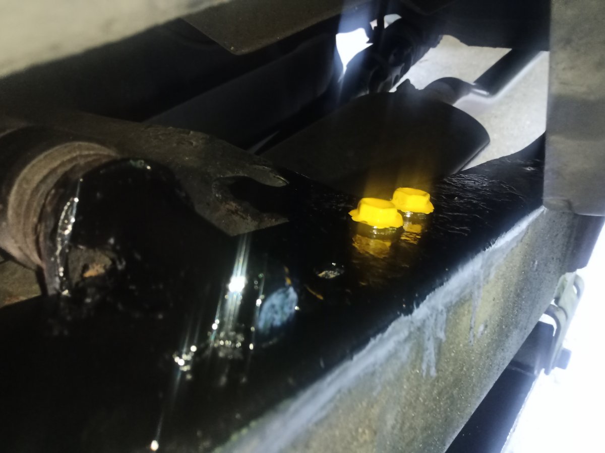

I can't say how long this paint will last
There are still remnants of yellow paint on some various bolts of when it was new
