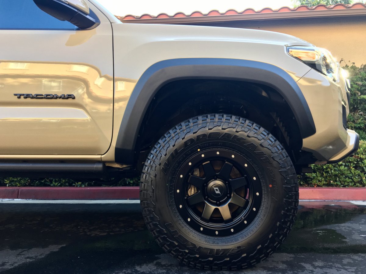

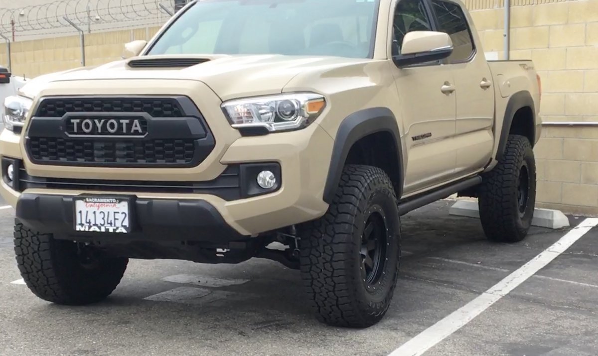

    Bilstein 5100s, Dakar’s, light racing UCA and OME 887 coils
    Stealth custom SR8s 16x8
    285/75/16
    Bogunn, Snaggle32 and OR17TRD like this.

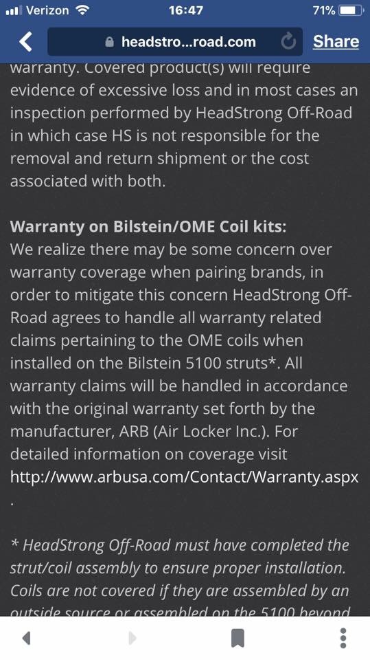

    Keep in mind, mixing OME and Bilstein voids both their warranties, unless you buy from a business that specifically states they cover the lost warranty with their own. And they have to assemble parts before shipping to you.
