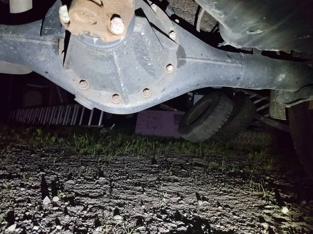

I just bought my truck last week. It's a demo that had 11000km on it and I had to go out and look and guess what I found20170723_231825.jpg

I just bought my truck last week. It's a demo that had 11000km on it and I had to go out and look and guess what I foundView attachment 12032
Sorry to see that. Welcome to the club. Seepage looks about right. Take it back to the dealer. Be prepared for them to keep it for a month :mad: or... torque the bolts down to 18 ft lbs for off-roads and 33 ft lbs for all differentials without the rear locker. Check it regular and keep your truck and wait until they actually have a fix for it.

I just came from the dealer my truck isn't on the recall list and I showed them the wet looking spots they said probably from being assembled and they said I have a upgraded pod which u don't know what it is. So they retoqued the nuts to factory specs. While I was there i ordered roof rails $470 plus new mats $150. I'll still keep an eye on the diff and any changes to that wet spot I'm going back to the dealer.20170723_231825.jpg
