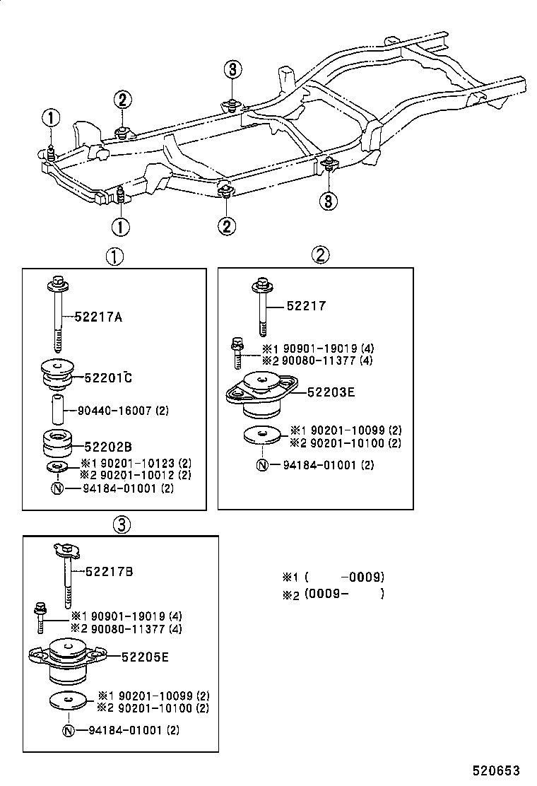

Indie Toyota shop did a rough estimate for those cab mountsYes. All. Take a look at the engine mounts. Don't forget the bushings and mounts for all the suspension. Ball joints, lower control arm mounts.......
Rubber from '97 can easily be degraded.
i am searching the YouTube to see whats involved for the DIYSeems rich to me......
I think you can do this yourself. It may take some jigglin' around to wrangle each cab mount out for replacement. Probably able to "lift" one side (ie driver's side) at a time to work that side, then do the other side.
Only need to lift enough to support the load off the mounts. Shouldn't need to remove the cab.
Remember, shops run on standardized labor hours. They probably are looking at a book for the cab removal/install procedure and the associated hours.
Before you do anything. You should confirm the mounts are good or bad.
